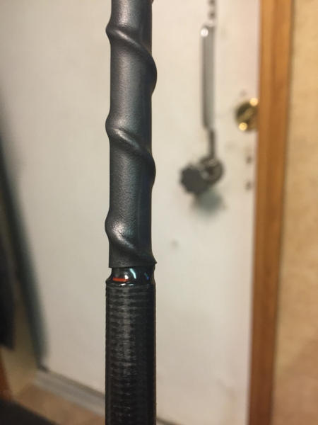

The plastic covering on my antenna had become worn and had exposed the copper coils in the antenna. Cheap fix, half inch heat shrink. Covered up the exposed areas and looks as good as new. And the good thing about it is if you can source specific colors you could totally customize the antenna.
