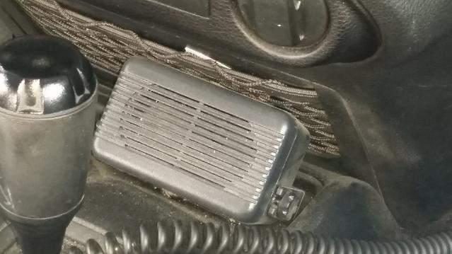

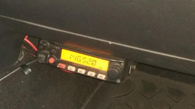

Here's a couple photos of my 2 meter radio install. Its somewhat out of view and not in the way of anyones feat or legs. i couldn't hear the radio so well, so i got that little Motorola speaker it fits perfect held in place with double stick tape. I wedged the speaker wire between the plastic to plug it in the radio.
Pull your glove box out and youll see the crossbar that i mounted the radio bracket to. Perfect fit.
Im thinking i might get a Cobra 29 and mount it right next to the 2 meter radio if it will fit.

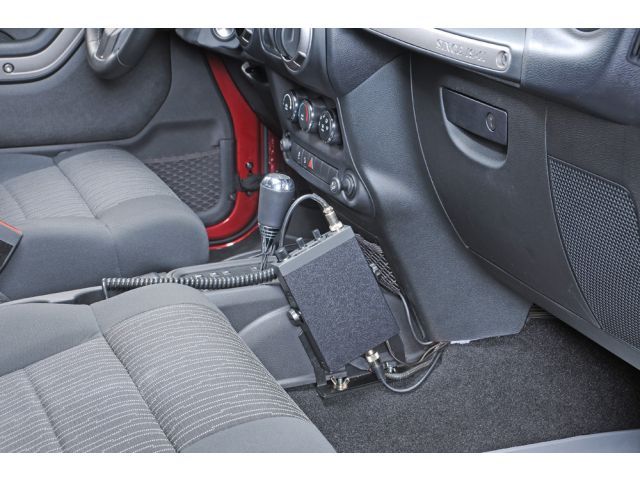

We went this route.

Quadratec Exclusive JK-APT2011 - 12 Volt Power Adapter for 99-15 Jeep® Wrangler TJ, JK , TJ Unlimited & Wrangler Unlimited JK - Quadratec
Quadratec Exclusive JK-CBM11 - Quick Disconnect CB Radio Mount for 07-15 Jeep® Wrangler & Wrangler Unlimited JK with Uniden Pro 510XL Radios - Quadratec

I agree with kmrtnsn. This mount looks almost factory, holds the radio well away from legs, allows the speaker to have its voice, and the base plate can accept a mount for either small or full sized radios. Two thumb screws allow easy removal of the radio when you don't need it, or easy swapping between a CB and a Ham radio.

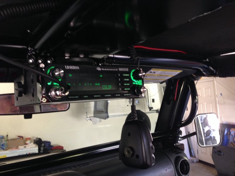

Used KC hi lights bracket to my RockHard cage mounted in front of spod
