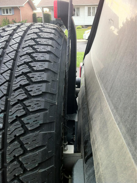

This is how i stand right now. Wondering if this is whats preventing me from transmitting and recieving for no more than 5 feet

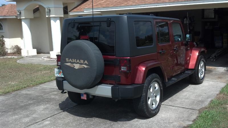

In spite of what I read here, I have my antenna mounted on the tail gate between the gate and the spare. It has performed great (SWR 1.0 - 1.4 and 5+ mile transmission) for over a year so don't tell me I need to move it. The reason (in my not so humble opinion) the gate mount works on a Jeep (and maybe not so much on a Tahoe) is because the gate is relatively short and the spare rim is not so big... so the majority of the antenna is not sandwiched between metal but extends above.
My antenna is a FireStik Firefly FL-4. It is NOT an ungrounded type antenna so it was very important the antenna bracket is grounded to the Jeep frame since the frame acts as the "couterpoise" which allows the antenna to propogate radio waves. Only ungrounded antennas work without grounding to the frame. With an ungrounded antenna, the coax shield acts as the couterpoise. Not as efficient as using the vehicle body/frame as the ground plane but better than nothing if your vehicle has a fiberglass body. (plastic Jeep? fiberglass fender mount?) Also, my antenna is insulated (not bare metal) although where the antenna screws into the bracket is exposed and must not be gounded. My antenna is very flexible and bouces against the spare all the time. Touching the spare is never a problem.
So, ground the antenna bracket to your frame and make sure the center connection remains insulated from the body.
Caveat emptor: This applies to CB not necessarily HAM, satellite, cell boost.

Looking at your mounting bracket, are you sure the antenna base is not shorted to the frame? There should be an insulating washer between them.

The little plastic washer between the braket is there... Its hard to see in the picture
