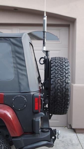

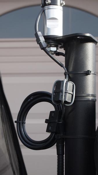

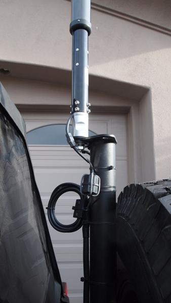

FT-857D, Little Tarheel II, and TurboTuner. Radio and tuner fit nicely in Tuffy full console.
I've been trying to figure out where to mount my ft-857d. I was starting to think at the drivers right knee would be the only place, but I have a soft top, and I don't want to lose the radio. At least using the remote head makes it pretty clear that there is a lot more to the radio.
How's the RFI with this setup?
Old Dec 16, 2010 | 11:09 AM
kb7our's Avatar
Joined: May 2007
Posts: 258

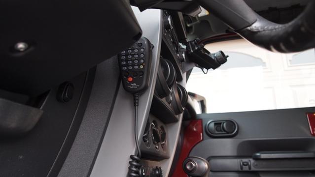

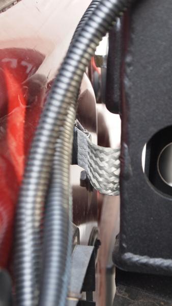

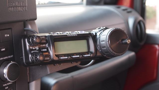

Separating the head unit works well for the mount I use and I can remove it in seconds to secure it in the console or under diver's seat in gun drawer. RFI is minimal to nonexistant with sufficient bonding, grounding, and chokes. Keep the coax choke outside the vehicle.
