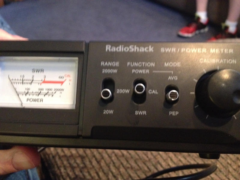

Does your meter also have forward and reflected power readings? Sometimes SWR readings can be misleading <long technical story>. But if your reflected power is reasonably low then you'll know the antenna is working satisfactorily (e.g. 5 watts forward, < .5 watts reflected).

Not sure what all the switches are on my meter... Here is a picture of it? Not sure if it helps or if it's capable of doing what your talking about....

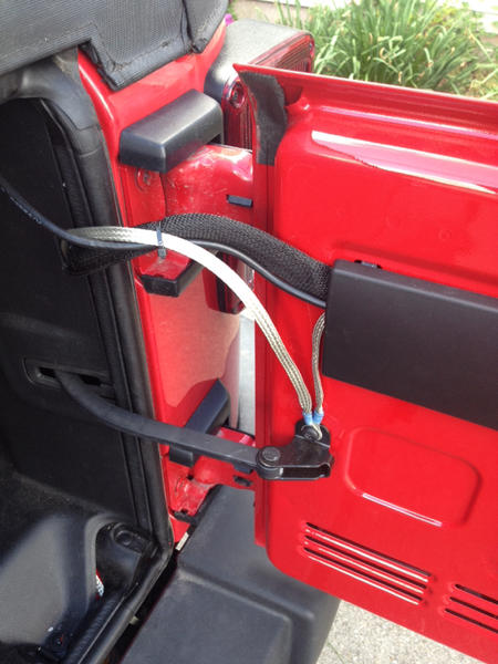

So I stumbled across something in a different thread that may be causing my problem. I think the hole in my bracket is a little too small and I'm getting contact from the stud on the connector to my bracket. Is it possible that is what's causing my problems?
Old May 18, 2014 | 02:32 PM
  #140
trouty33's Avatar
Joined: Nov 2013
Posts: 575
From: central PA

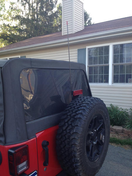

Ok so I reamed the hole out bigger so the mount stud for sure didn't make contact to the bracket. I also had to move the bracket down to the next set of screws in the third taillight due to the top screws screwing into plastic (it felt like it was loosening up). I drove out hooked up the meter and 1 was 2.5 and 40 was 3. So I went back tightened all my connections up and double checked my readings.
1-1.2
20- 1.3
40- 1.5
I will take that with a non tunable tip. Took the meter off hooked it back direct and away I drove. All sorts of chatter while scanning. Click image for larger version
