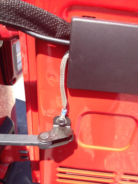

Ok so I ran a ground strap from the mount to the one bolt in the little swing arm hing or whatever the thing is??? Ran swr meter and needle is at 3.5 roughly on 1 and 40. So my next effort is to run a strap from the first ground to the frame I guess, would that help?

Ok so I ran a ground strap from the mount to the one bolt in the little swing arm hing or whatever the thing is??? Ran swr meter and needle is at 3.5 roughly on 1 and 40. So my next effort is to run a strap from the first ground to the frame I guess, would that help? <img src="https://www.jk-forum.com/forums/attachment.php?attachmentid=551372"/>
Does your antenna have a tuneable tip? My Firestik Firefly started around 3.0 but after tuning it, I was able to get it down to 1.3 or lower across all channels. It took quite a few small adjustments to get it just right. Also, make sure you are in the clear with no nearby obstructions (trees, buildings, etc.) when you take your SWR readings and make adjustments.

Which direction did you have to go to get it down longer or shorter? The needle came back and since was in the red I didn't get a real number but was VERY close to the same spot for both 1 and 40. This antenna does not have a tunable tip, but if this doesn't work I will be ordering one! Location is my other issue I stopped by the local baseball field parking lot but maybe the fence and dugouts were messing me up too. I was probably 50 yards away but was thinking of going somewhere even more open... Just have to think of a good spot cause there's trees everywhere here.

The tire carrier is what used to be called pot metal. It is a very light metal. I have the same Midland Radio, and it just ran a ground wire with the Coex Cable even though now I have a AEV tire carrier mounted to the frame. I get about 1.6 - 1.7 on my meter with a three foot Firestick. I had a four foot fire stick on the stock setup.
