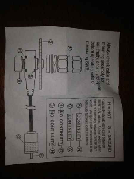

This Diagram shows that the antenna bracket 'G' is indeed grounded to the coax shield wire:

Originally Posted by troyboy
I've seen these pics. I assume that since that bracket is stainless then the fire ring's steel ring is touching and thus grounded. Therefore the coax shield wire is grounded to the antenna mount bracket. Correct?
Yes the metal part of the ring with the shoulder should you the mounting bracket. If you are solely using the bracket for you ground, you should remove any paint or powder coating. However, the ground may still be questionable. You should run a wire or strap from the body to the mount or shoulder side of the ring.
