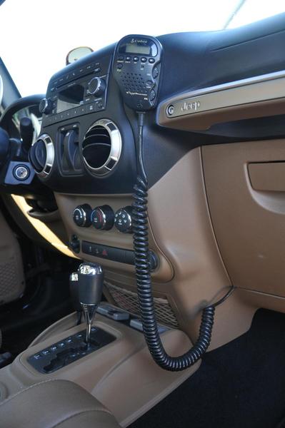

I installed a Cobra 75 that has been sitting in my garage for awhile into my JK this weekend. I mounting the power box behind the glovebox and just let the cord come out of the bottom corner of the glovebox. This way there are no holes to drill. I got a body mount from a
local CB shop so I could mount a 4' antenna to the license plate housing, this allows the coax to be totally hidden. It is less than a foot above the roofline. I still need to get the SWR set, but it seems to work well as it is.
