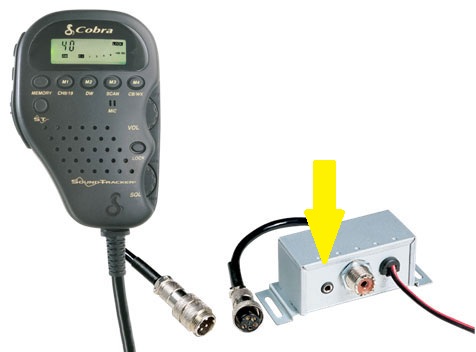

You know the "box" part of this cb has an audio out for running an external speaker right? Why not just run an external speaker or, like some on this forum have done, run a male/male audio cable from the box to your "input" on the front of the radio?
+1. I ran like this until I bought an external speaker. Just switch your radio to Aux and you are in business. Too bad the plug turns off the regular speaker.
Yep that is true...

i'm such a donk. thanks for reminding me. i vaguely remember seeing that. saves me some tear down/ solder time.
owe you one

Put an externial speaker on mine, mounted it on the speaker bar and it works great.

I will have to keep the bluetooth thing in mind. My wife has a '10 grand caravan (company car) with upgraded stereo we'll be keeping when it hits the 60k mark and she turns it in.
For now I just keep an aux cord plugged into the box, and stretch from glove box to aux jack when needed. works great.
