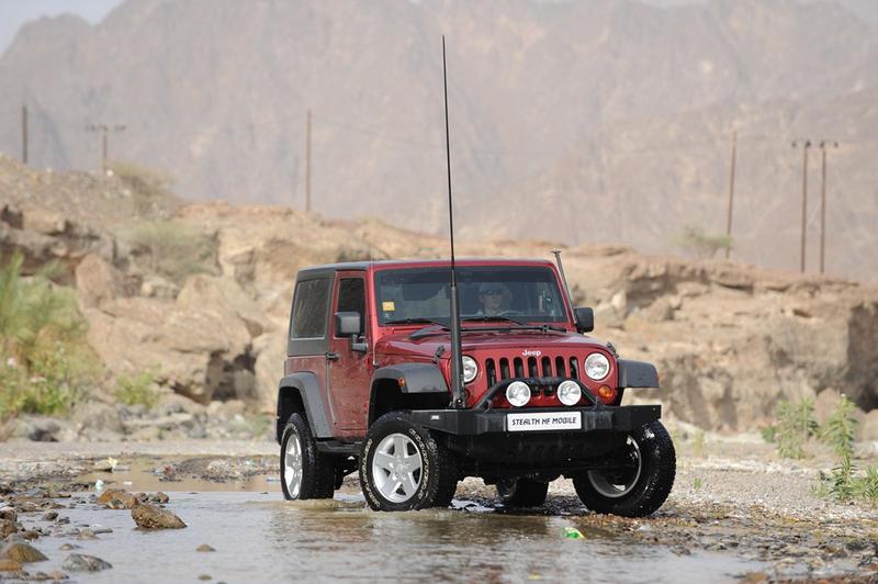

Hi!
Can you post a pic with direction, on where did you run the coax from?
I got same issue with HAM bands. Mainly 40 and 80 meters, Airbag light goes on. The Antenna setup is complitely different, but the issue looks same.
Currently got multiband HF ATU HF Whip, from 1.5 till 30Mhz, with TS-480 (at the moment 100 Watts), grounded on frame and body.
Thanks in advance.
Serge, A65BU / UR5WJQ

My Antenna is insatalled in front, on the bumper.
Name:	DSC_4783 [1024x768].jpg
