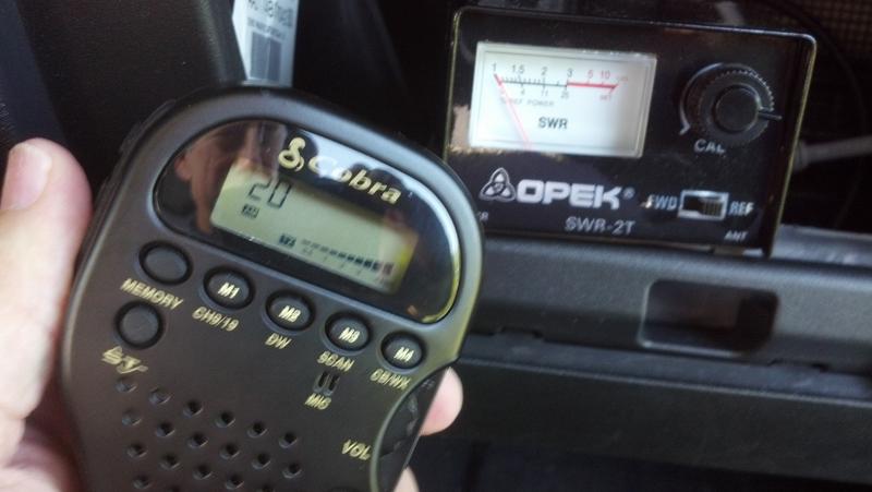

The Cobra 75 has a 4 watt output like any "legal" CB. The transmission strength (and hence distance) is a function of how much of that 4 watts leaves you antenna and gets transmitted into the air. A good antenna with good installation and tuned for unity SWR is the best you can do. My transmission on the interstates based on trucker (driver) replys is 4 to 5 miles. In town and on the trail it can be less depending on terrain and trees (pine needles hurt the most).
