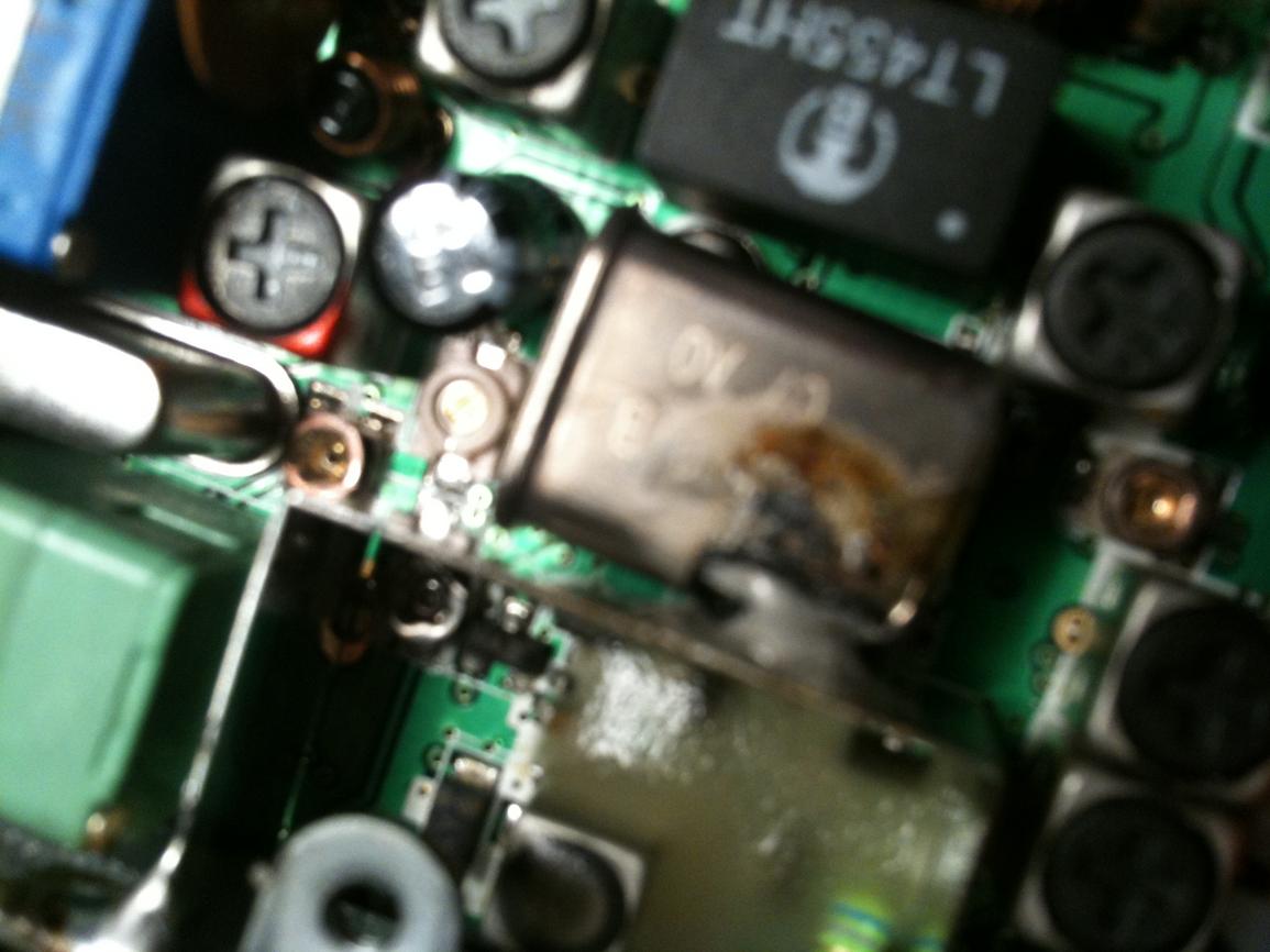

well i just took my cb apart and it doesnt look to great. there is a silver thing (it sort of looks like a capacitor but could be the 4w transistor) has burst and burnt. not sure if that is something i can fix. can you normally buy replacement trasistors for cb's?
so skippman you might want to unscrew you cb and just look for a burn thing inside.
actually now that i lookat it i can see the transistors and they look fine, i think its a burst capacitor

Oh no! It's the dreaded fuzzy bomb!
Originally Posted by scotlandjk
... i think its a burst capacitor
Old Sep 3, 2009 | 12:33 PM
scotlandjk's Avatar
Joined: Aug 2008
Posts: 770
From: Aberdeen/Edinburgh/Devon, UK
haha yeh my iphone is not too great at photos. but you can sorta see the brownish black area where it popped

digikey.com and perform a search for the numbers on the blown cap..But chances are you'll replace the cap just to find something else also has failed on the circuit board.
