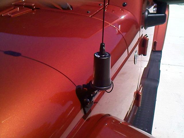

FWIW, this is what Im running on mine.
Its a Diamond K 412 mount and a Larson 2/70 NMO antenna mount.
Iv been using a Yaesu handheld and it seems to work fairly well for me.
Hopefully, by years end the HT will be replaced with a Yaesu 8800.
Hope this helps.

Donnie, that looks like a very clean install, and the NMO 2/70 seems to be VERY popular for a dual-bander.
Is it a clamp mount?
