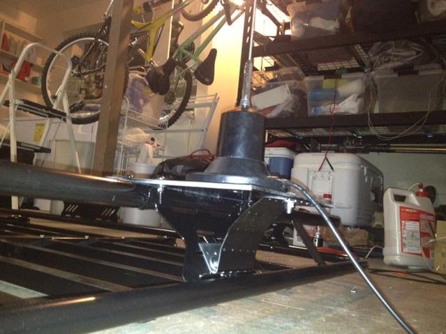

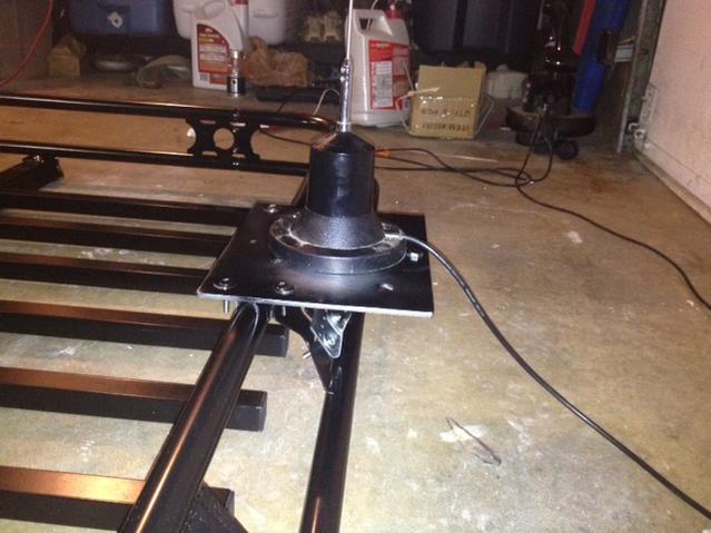

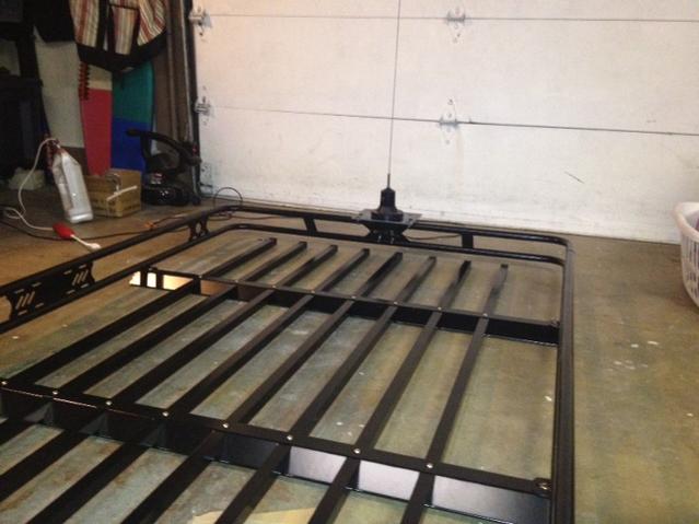

You could put it on top, if you want max range. I just made this magnet mount today, with Home Depot parts.. Still need some modifications and trimming to look good... I'll test it this weekend in Anza Borrego. It has holes for regular mounting too.
I know it will be a PITA in the woods, so I have another mount for that use (Arizona Rocky Road).

I took my license plate mount off and put the plug in the hole. Then I just drilled a hole in my bumper about in the same place as my license plate mount was. Put the stud directly in the bumper... easy to ground and the Gobi rack is out of the way. I also then put little foam balls on the antenna to prevent it from hitting my hard top or soft top when I have either on... lastly' on the highway I take a nylon strap and connect it to the top of the antenna and the side of the rack... prevents the antenna from blowing around on the highway a bunch.
