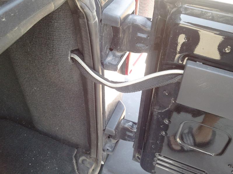

Old Sep 20, 2012 | 10:55 AM
nateo1979's Avatar
Posts: 46
From: layton utah
I grounded the whole tailgate
