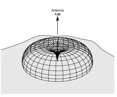

The radiation pattern of a vertical antenna is a 360 degree torus pattern perpendicular to the axis of the antenna. Think of a doughnut with the antenna going up through the hole.
Mounting a vertical antenna inside the bumper would limit the radiation pattern only to the front and back. Most of the radiated energy would go up in the sky or down to the ground.
3D view of vertical antenna radiation pattern.

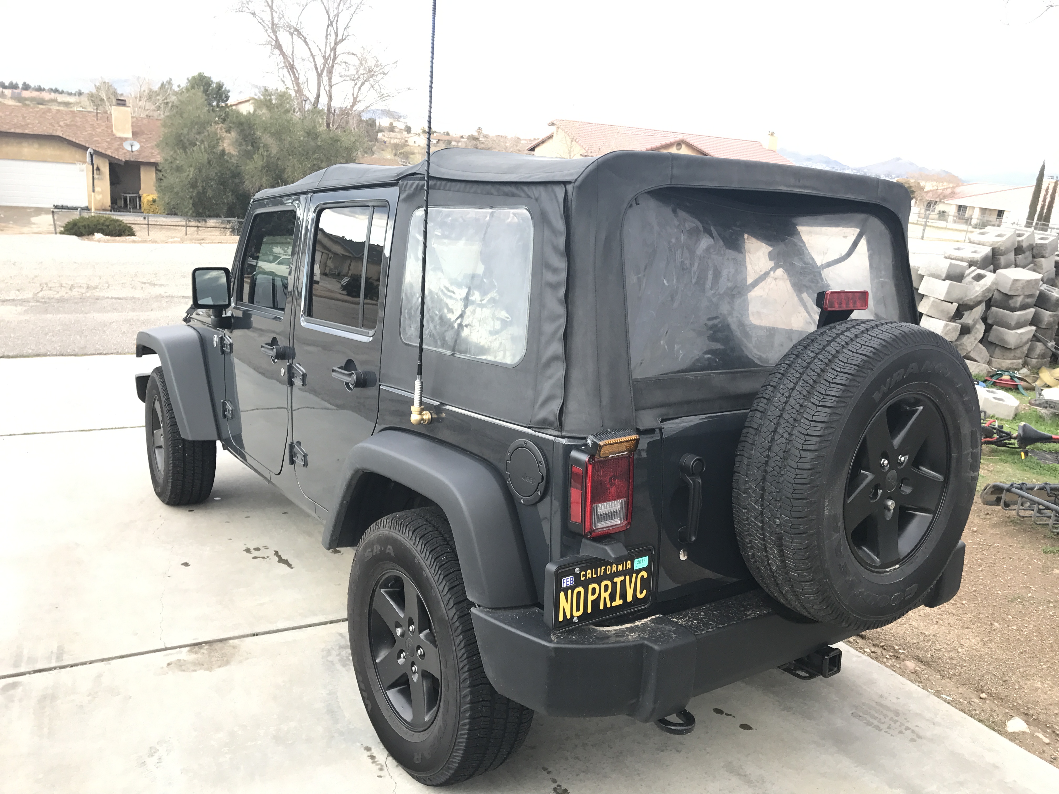

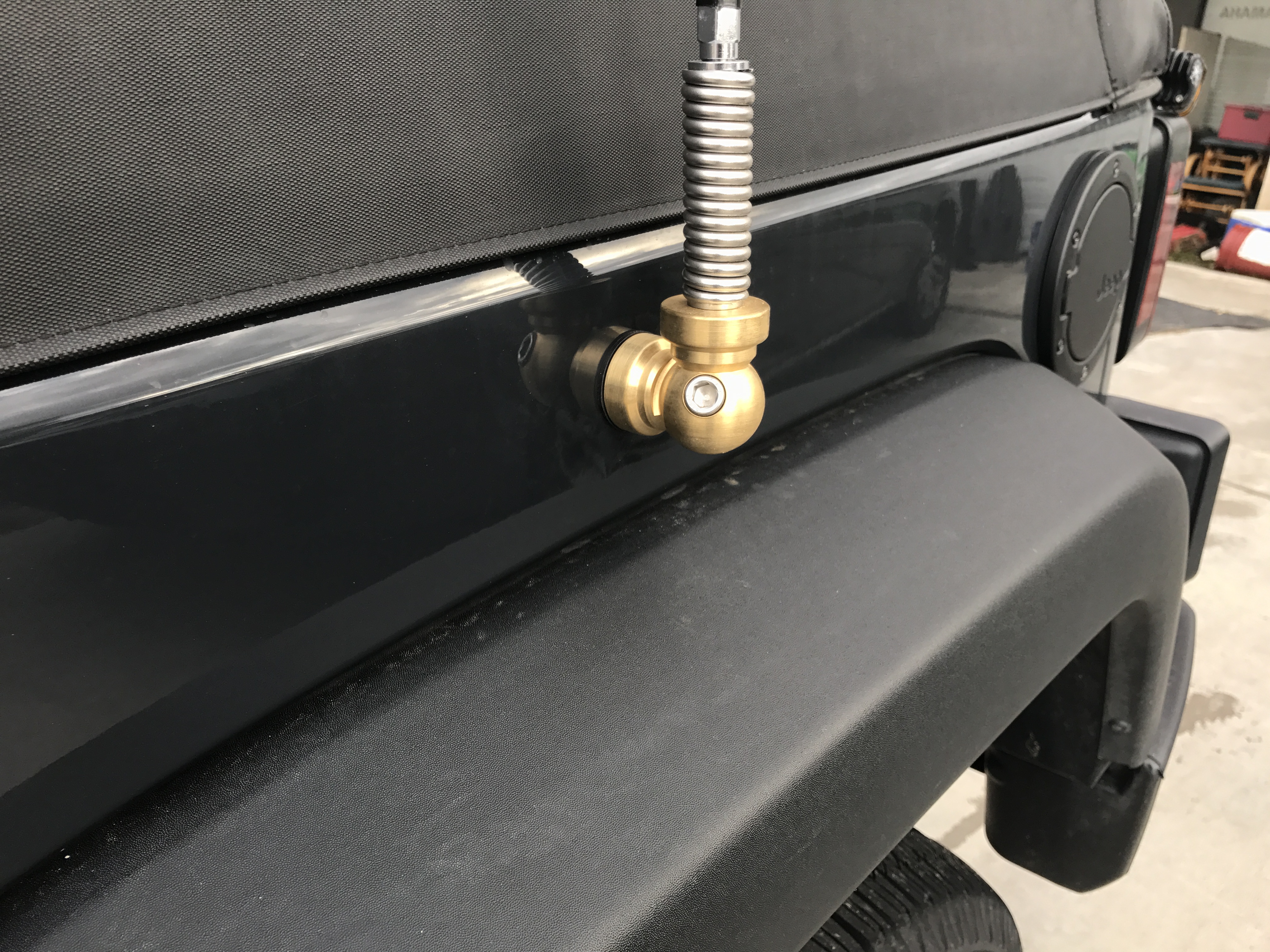

Does anyone have radio interference (Cb or Ham) having the different VHF antennas mounted so close to each other? I to am trying to figure out where to mount my 2 Meter antenna. I'm debating if I should put it in the back, or move it to the front drivers side between the hood and the front fender. My CB Whip is on the rear drivers side fender. KK6AJA

Put it in the back, right side should be ok. I have a CB and dual band antenna on roof, right rear side about 2. Ft apart with no problem along with a large HF antenna on tire carrier.

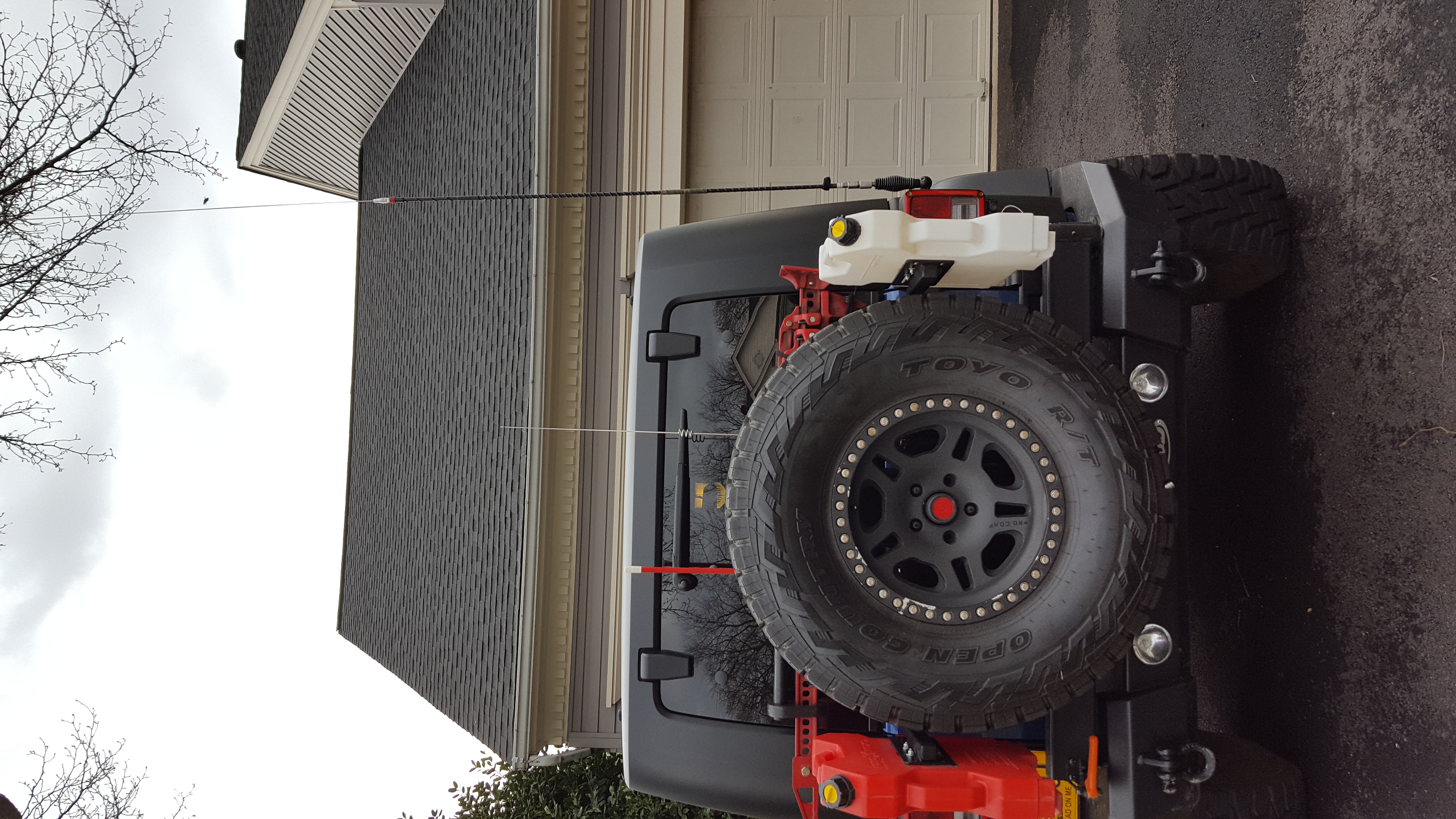

I have 3 antennas on the back. The setup works well. You do want to make sure that the load coil is up as high as you can get it. There is a lot of metal back there with the tailgate and tire carrier. If you are using a base loaded antenna, then mount it higher or get a center or top loaded antenna. The whip you have with the Breedlove mount is optimal, (doesn't get any better).
What you will find is that when transmitting on one radio, it will saturate the front end of the others and you wont be able to receive on them while the mic is keyed. I think this is unavoidable.
CB, VHF/UHF, HF
