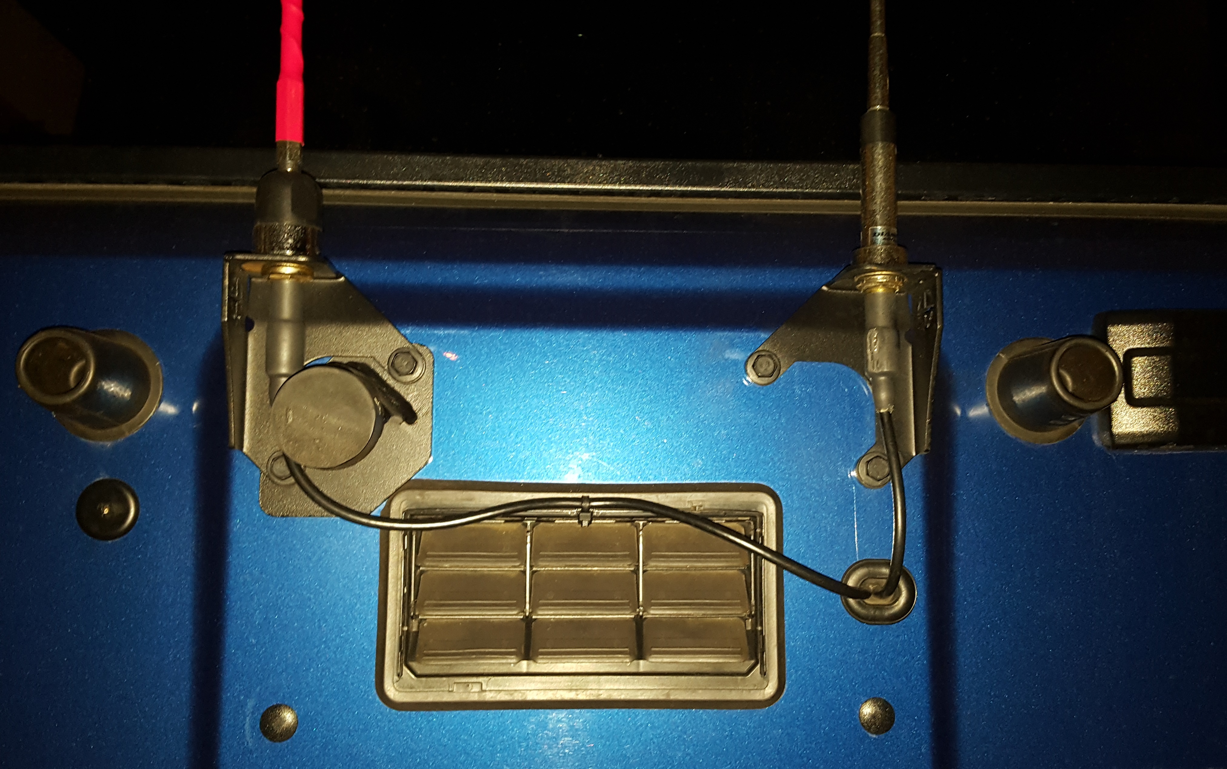

I have the EVO Tailgate mounts. They are the only manufacturer that makes one for the drivers and passenger side.

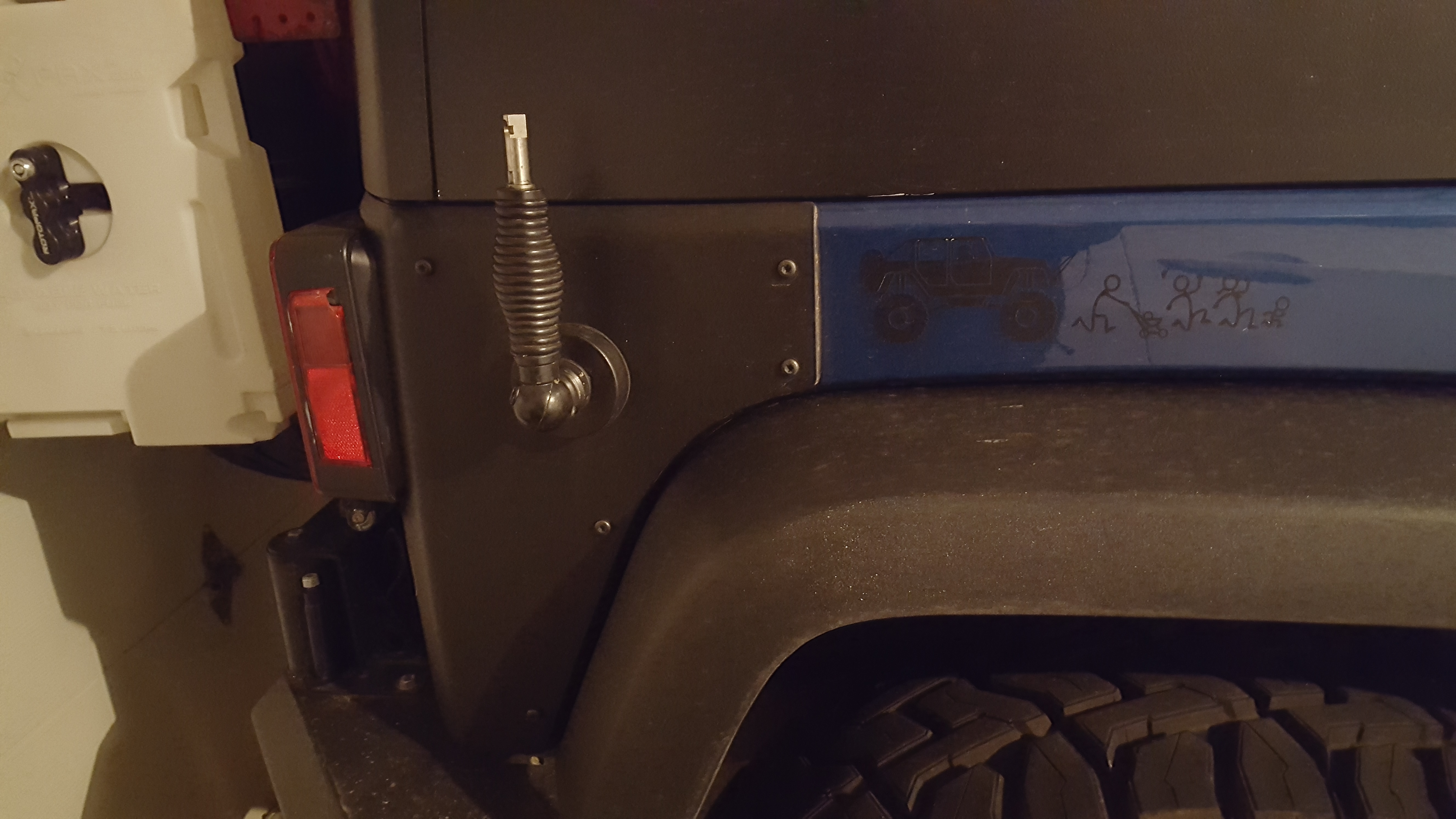

I am using the Breedlove mount for my HF antenna. Originally I had it mounted on the fender with the backing plate but a tree hit it once and dimpled the sheetmetal. My repair was to install the AEV corners and now it is solid as a rock. I actually rubbed against a tree last year that wiped the fender and the tail light off but the antenna was still standing.
