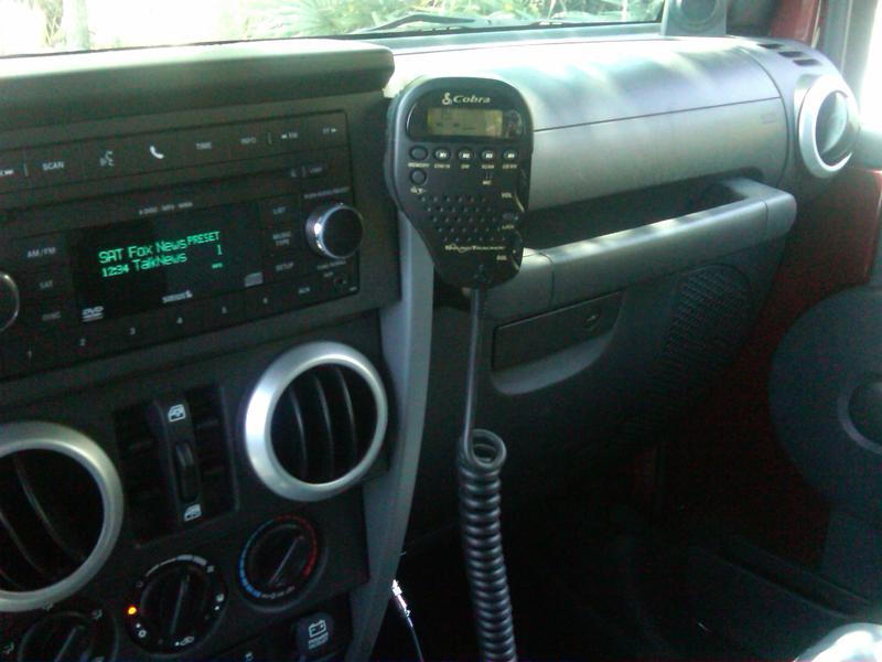

Can't beat the clean look of the cobra 75 with the cool tech mount. Sucks that you can't add a PA to it.

That does look clean!

Where did you mount the mic connection at?

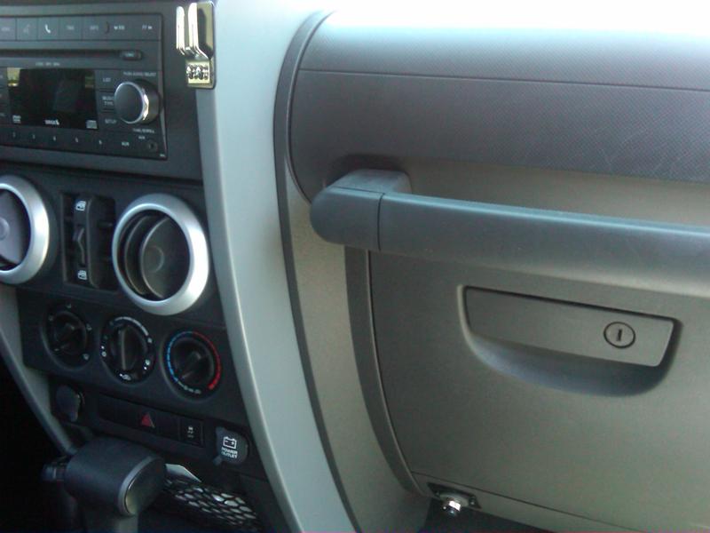

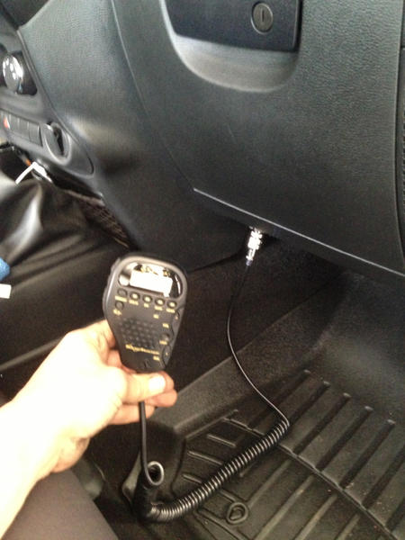

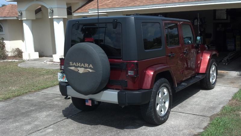

Don't know the Uniden. I've had the Cobra 75 for almost 2 years. Still works great. Went with the CoolTech kit. The mic mount on my 2010 JKUS is a little different from the 2013. I used the GateMount with 4' Firestik so the antenna is more protected. About a 4 mile range. Always get an SWR of around 1.3 - 1.0 - 1.3.
Best thing is I can disconnect and store it in the center console and nobody knows I have it (except for the mic hanger).

Took out the glove box and zip tied it to the metal structure under it, saw it on you tube, just search wrangler cobra install.

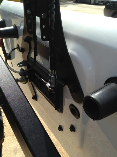

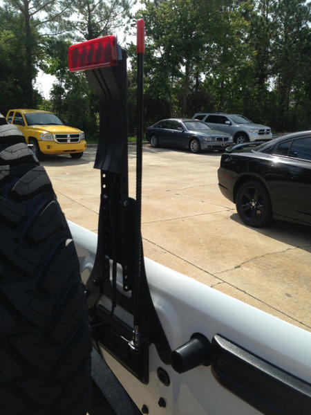

Installed mine today, thanks for the info and ideals
