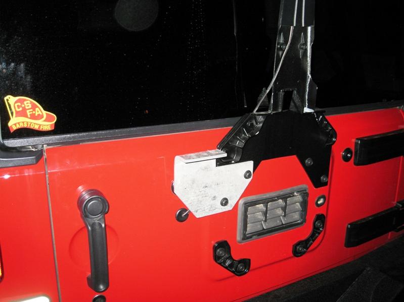

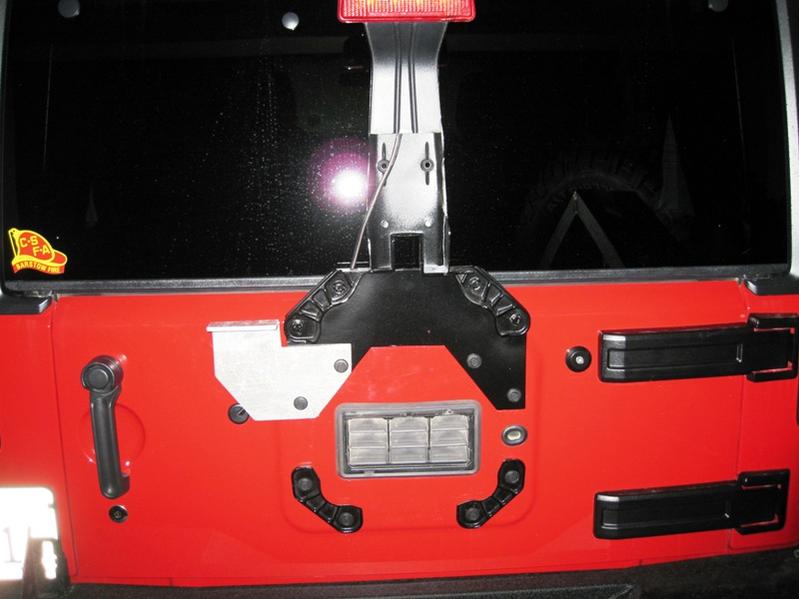

These are a simple design. You can use angle or flat aluminum stock (1X1" angle or 1 X 0.25" flat) from local hardware store. Bends very easy with propane torch.
ARIZONA ROCKY ROAD ANTENNA MOUNTS FOR JEEP WRANGLER, UNLIMITED AND LIBERTY
I had some 0.25 sheet so this is what I made..

When I used the OEM tire carrier, I cut off the red wart (3rd brake light) and drilled the carrier for a stud:
When I went to bumper mounted carrier, I just used a piece of angle aluminum:
