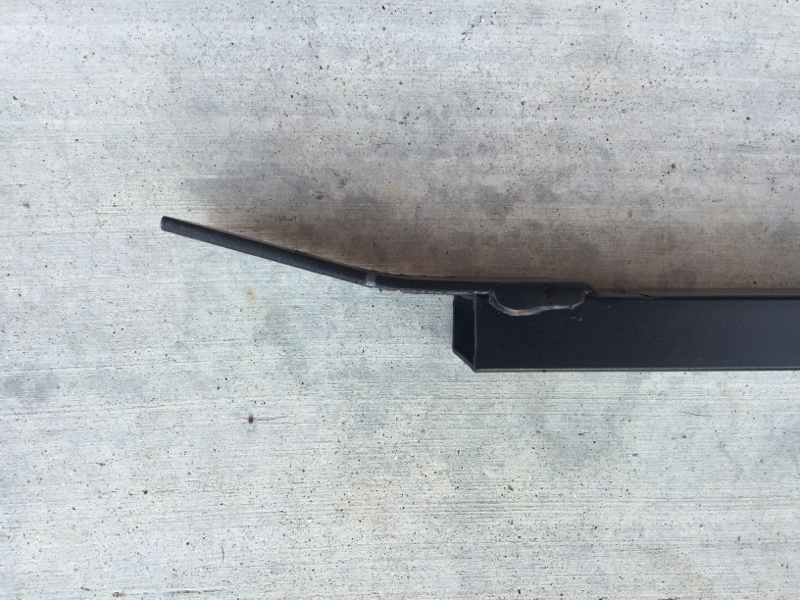

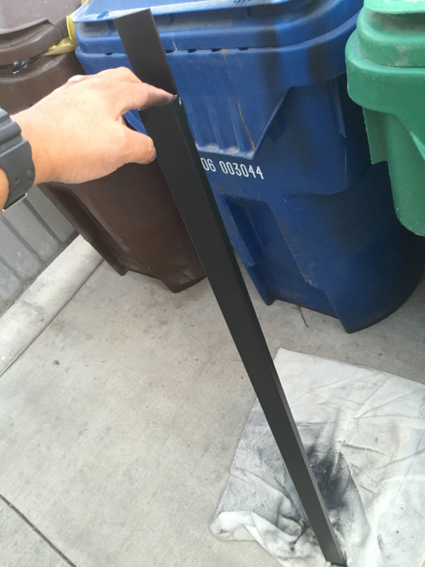

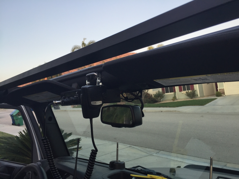

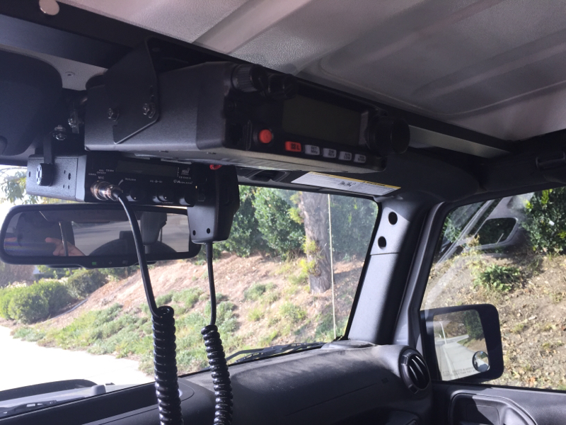

Hey all, decided paying nearly $100 for an overhead bar was too much so I made my own. Cost under $20 Used 3/4x1.5" rectangular tubing and 1.5" flat bar. CB is attached to the footmans loop. Overhead bar is for the Yaesu 2900. -Robert K6DTF Click image for larger version

Looks nice how did you fasten it to the jeep?
one small sheet metal bolt at each end. Just enough to keep it from moving around.
