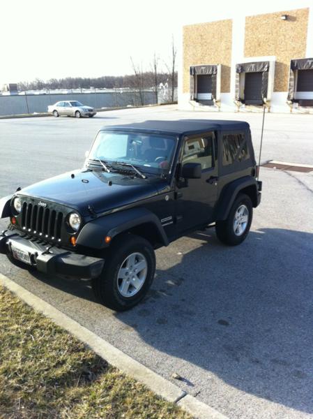

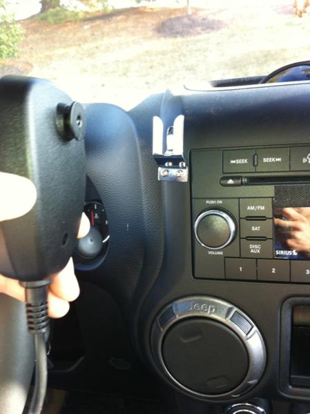

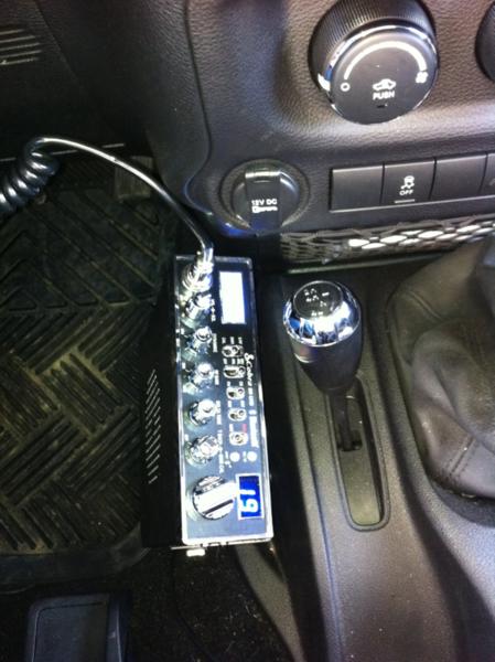

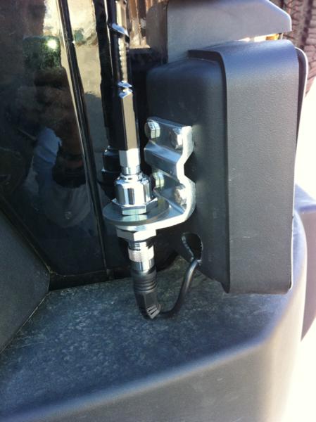

Installed a Cobra 29 LTD BT 40 channel cb radio with a 4' Firestik antenna mounted off the back of the license plate. Cable runs along the edge under the carpet wiu the rest of the auxiliary cables.

Thanks everyone! I appreciate all the options/pictures, looking like upsidedown gatemount for me, but I'll wait till ludski's pictures to figure out the antenna height! The license plate just isn't my favorite spot to put it. How much cable should I get to run it over the roll-bars?
