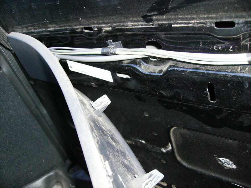

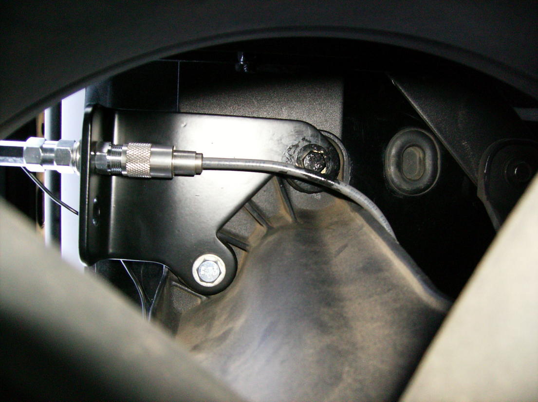

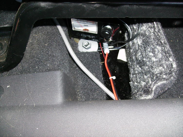

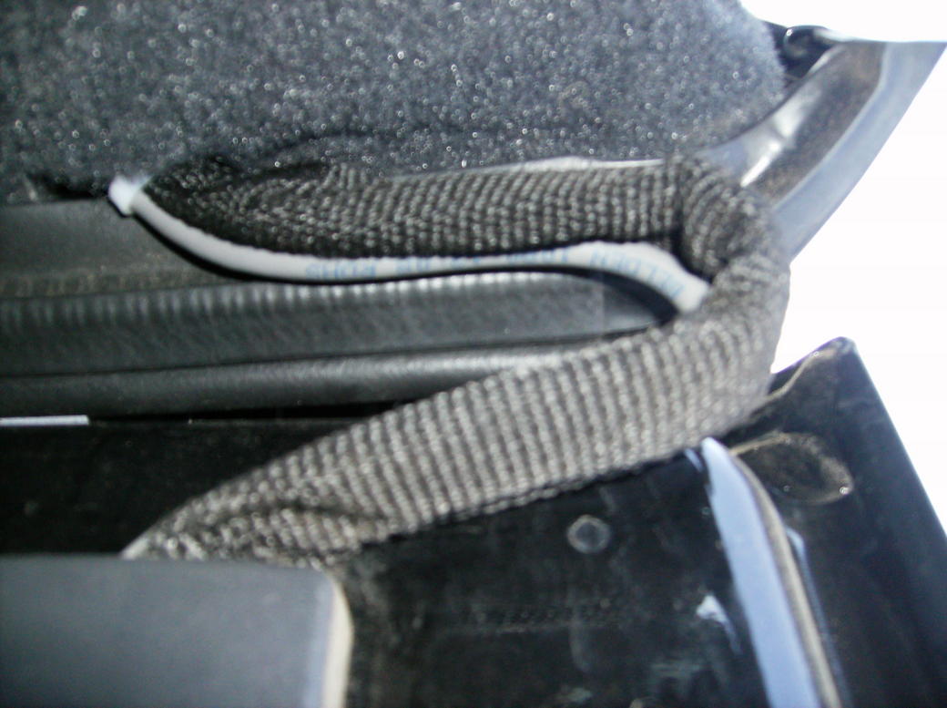

Here are the pics for the antennae attachment. As you can see in the first pic, there is plenty of wire to follow - I had also zip tied to keep it in place. Second pic is the wire coming down off of the JK Ant Mount down into the rear vent. That wire then follows through and out a little port hole behind the cover plate on the inside of the tailgate (third pic). From there I just followed the lines underneath the carpet up to the driver's seat. Next post will have pics for the box/mic placement.

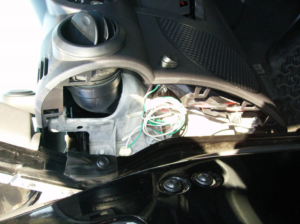

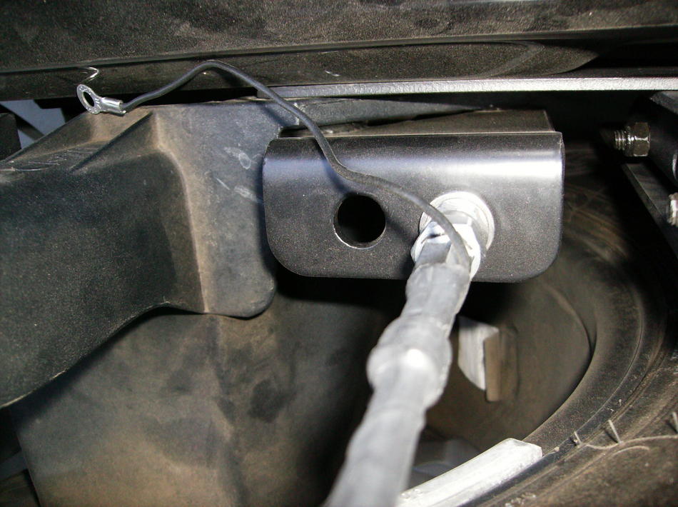

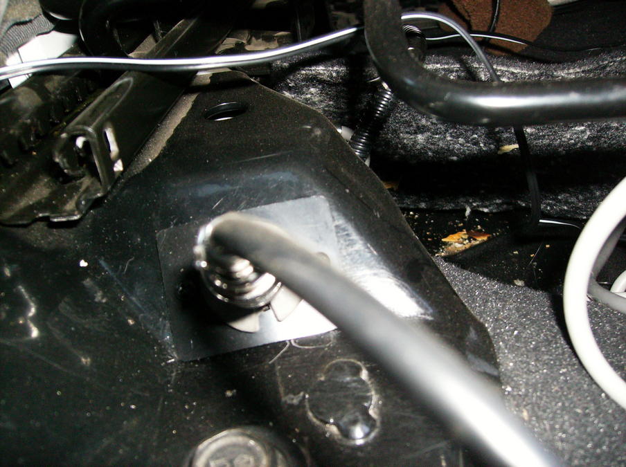

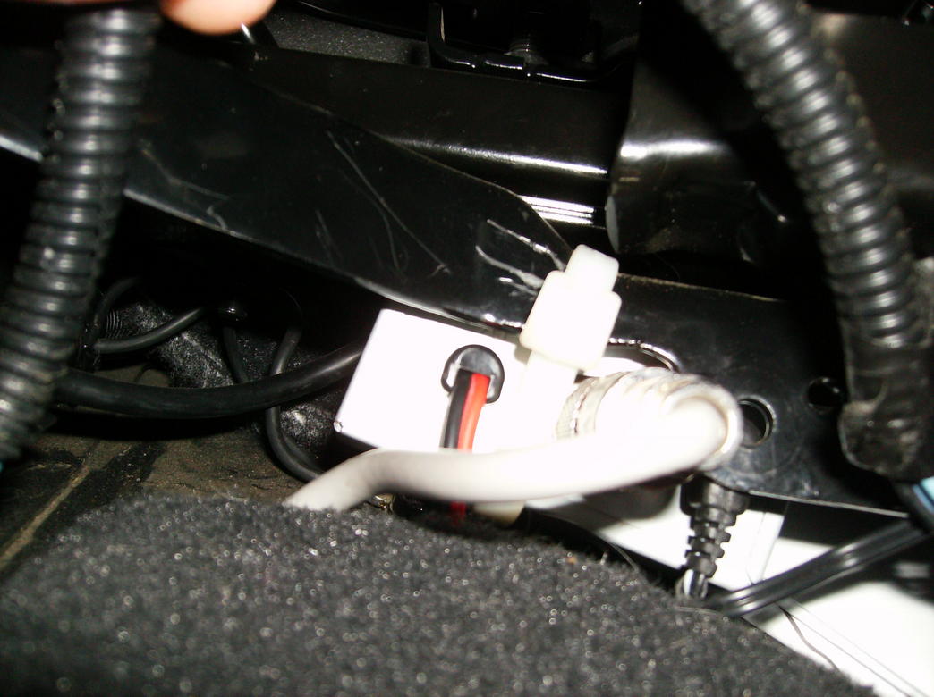

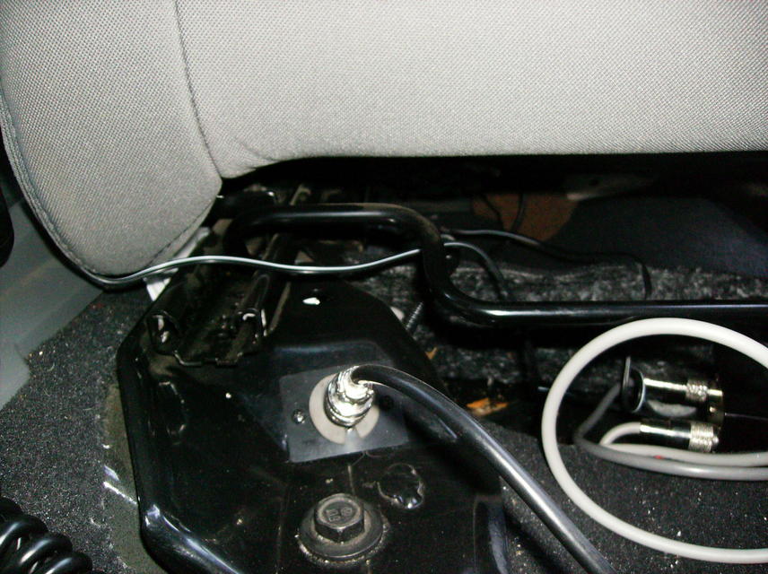

Here are the pics for the CB/mic placement. The first pic is the control box underneath the slide rail for the seat. At no point does it come into contact with seat or other moving parts - so it seemed like a safe place to put it - out of the way. The only trick is to have it loose to connect/disconnect the tester before securing underneath - very tight. From there, wire were run underneath the carpet to the plastic cover - easily popped up to place the wires inside and run (either from the antennae or to the power source). Third pic is the port hole I put in the seat mount. A 1/2" hole did the trick - just a little sanding to smooth it out and good to go. From there, the mic is easily attached/detached. For power, I had tapped into the power line for my KC lights I had mounted on the windshield. My power line came through the firewall behind my steering wheel (pic 5). I just popped off that side panel and ran the wire up to it. Also, the fuse for my CB is also just under my seat, so if I do blow it, I can easily access it.
