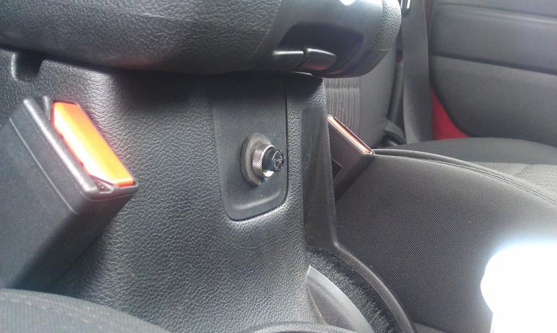

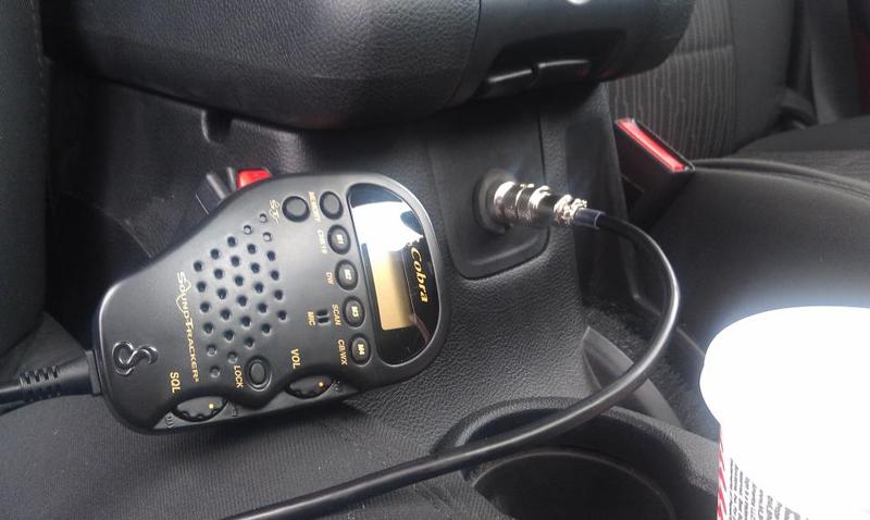

I mounted mine inside my center console and used the power outlet feed right there to wire in my power and ground. Turned out great, and I have no feedback from using this outlet. It is constant power so you will want to remember to cut it off. I have left mine on a couple of times and the battery was just fine.
