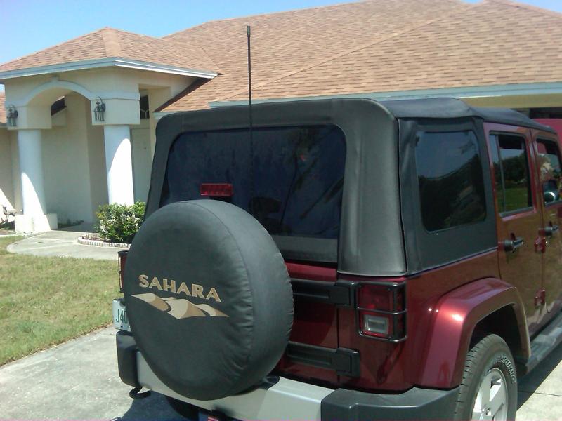

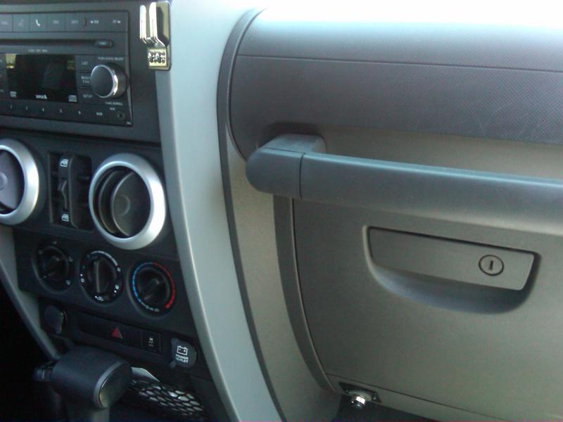

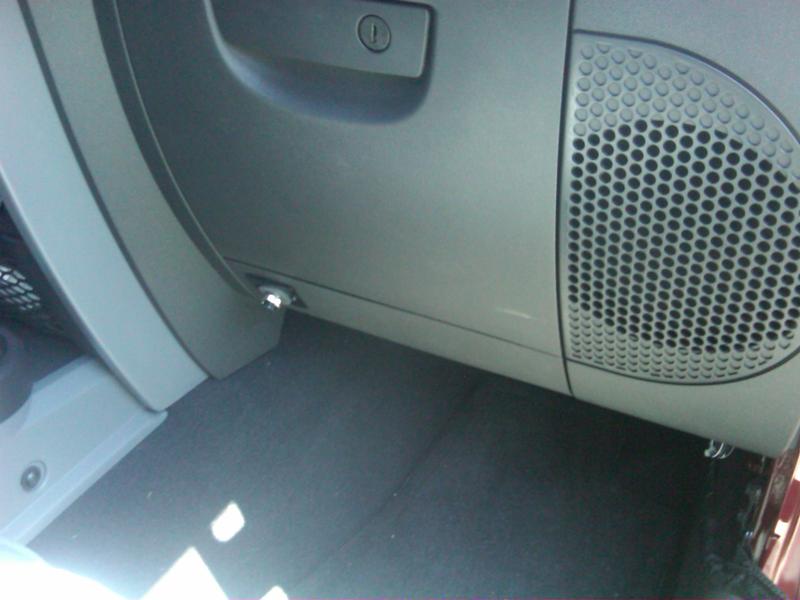

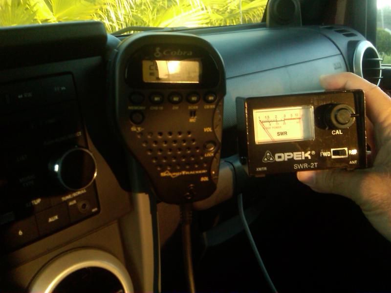

What's you thoughts on the install. Do you want to go for the duck tape and bailing wire look or do you want something that looks factory?
Lots of options and lots of opinions. I can only tell you about mine (my personal experience).
I wanted a decent CB with the least amount of modification (holes). I also wanted something that looked clean. Like it really belongs.
I chose the Cobra 75 kit from CoolTechLLC.com because it fit my requirements best. I've had it for almost a year and still love it.
I live in Lakeland and it comes in handy on I-4. Truckers give you heads up on wrecks and alternate routes. The range is 2 to 5 miles depending on trees, buildings and terrain (yes there are hills [and gyp stacks] in the Florida Highlands).
As you can see from my picks, it's very inconspicuous when you disconnect the handset and put it in the console for safe keeping.

I don't always use my CB and when I don't it goes in my center console. Now you see it.... now you don't. No temptation for the idiots who don't know Jeep tops have zippers and have no idea that you can't play Angry Birds on a CB.
The only "permanent" modifications are the single hole in the cheap plastic kick plate under the glove box and a small slot through a rubber grommet in the tail gate to pass the wires through. The mic holder (VersaMount - Veramount2 for 2011+) and antenna bracket (GateMount) use existing screws or new, longer screws for existing holes. The under-the-glove-box radio connection box can be tyrapped in place.

How would you feel about maybe helping me out with the install and helping me tune it up? I'll bring you some brews as payment lol (don't really feel like dropping another $30 for a Swr meter that I'm going to use once).
From what I understand you attach the antenna and the cb to the meter and then tune your antenna and then take it off and leave it be. Correct me of I'm wrong
