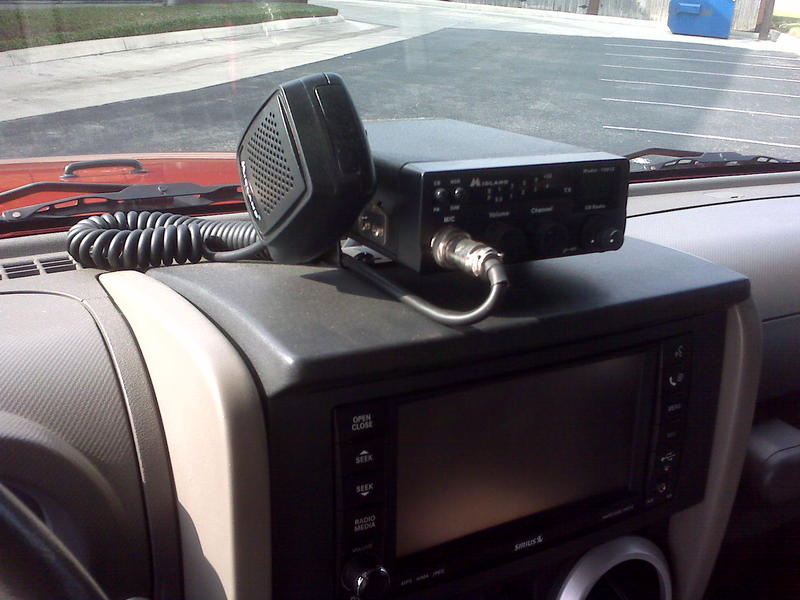

The Midland 1001Z CB is a good entry level CB that is not very expensive. I installed mine on top of my upper dash bezel and then got a second one from a forum member so I could remove it when I don't need it. For my antenna setup I bought a FireStik LG3-M2-B no ground plane (NGP) antenna kit. The molded side mount is easily mountable to the rear license plate bracket and the supplied cable reaches from the radio down behind the center dash under the driver's seat along the driver's side of the vehicle and down through the grommet in the top of the rear fender into the license plate bracket. There are no exposed wires and everything can be removed so that it's virtually impossible to know that I've ever installed a CB at all. Here are some pics and a link to my photo album that has more information on my setup. It is easily installable in a couple hours and it works great. The entire antenna kit is only $50 and includes the mount, the antenna, and the coaxial cable that connects the antenna to the radio. Click the Where to by link on the FireStik website for a vendor near you.

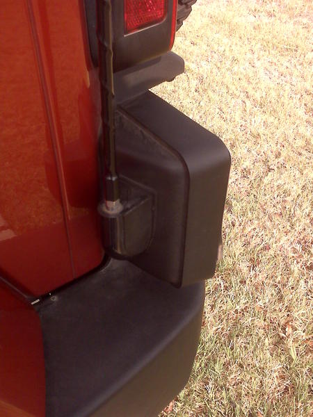

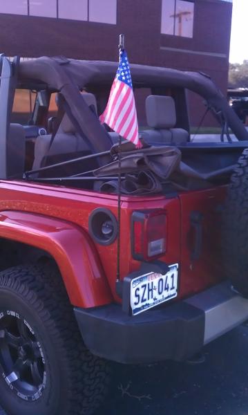

A shot with the antenna and my Old Glory flag flying proud!

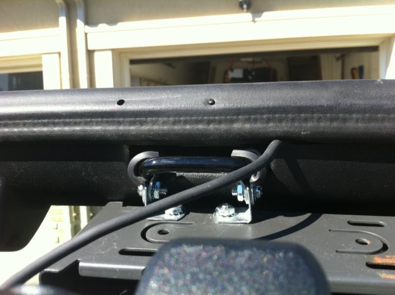

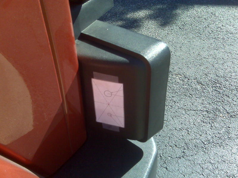

A shot of the license plate bracket with a mockup drill template used to locate the side mount.

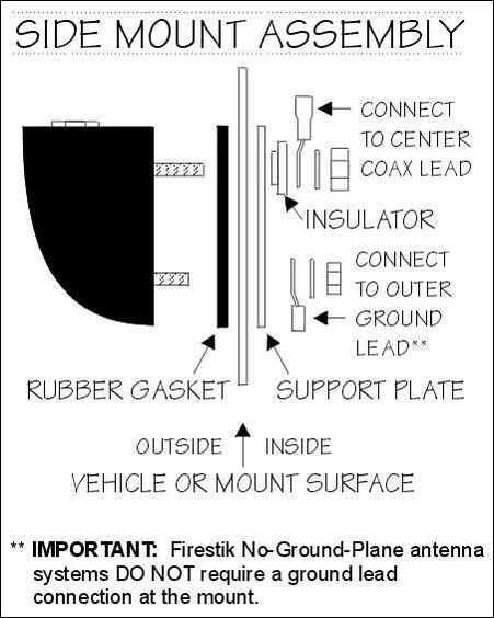

A FireStik illustration showing how the molded side mount secures to the vehicle.
A closeup shot of the mount and the antenna installed
Another shot of the mount and antenna installed. See how inconspicuous the mount is on the license plate bracket.
Finally a shot of the radio on the upper dash bezel. You can mount yours anywhere between here and the back of the vehicle and have plenty of supplied cable left to make it between the radio ant the antenna.

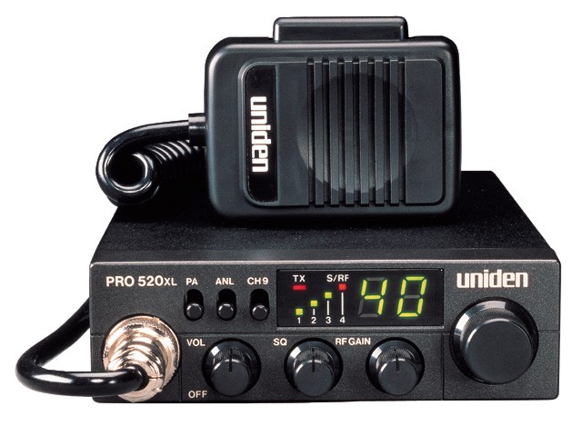

Uniden 520 XL
I would recommend the Uniden 520 XL after digging through about every post on CB's I can find. It is everything you need and no extras. Fry's seems to have them the cheapest.
-small,cheap, tough, simple and works good with a good antenna setup.
There is also a 510 XL for about 10-15 dollars less. You loose the R/F gain, an automatic noise limiter, and the ability to make it into a PA system (if you install a horn).

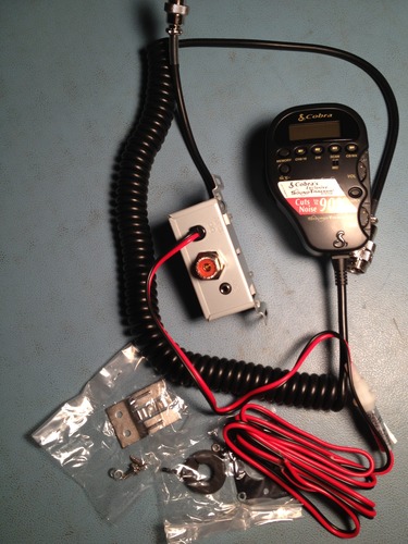

Cobra 75 WX ST
As far as handhelds the Cobra 75 is a good option and is super popular . The speaker on it is a bit weak. You really need to get an external speaker for this one. It doesn't have a PA option, and the squelch and volume are a bit hard to use. You will have to mount a small body piece in addition to having the hand held. It has a ton of cool features like:
