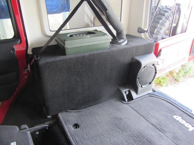

Hey - nicely done. I wonder how you managed the wiring and charging? Also, reminds me of a past project where I built a carpeted box that contains items inside (tow strap, etc.) and a removable box that contains tools. I've often thought that placing (a well secured) second battery would be ideal there.

Your setup looks very nice and professionally done. The Springtail rack accomplishes the same thing. I plan to get the passenger side to provide some additional storage room similar to your setup.
