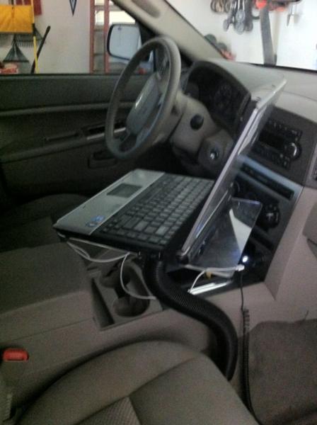

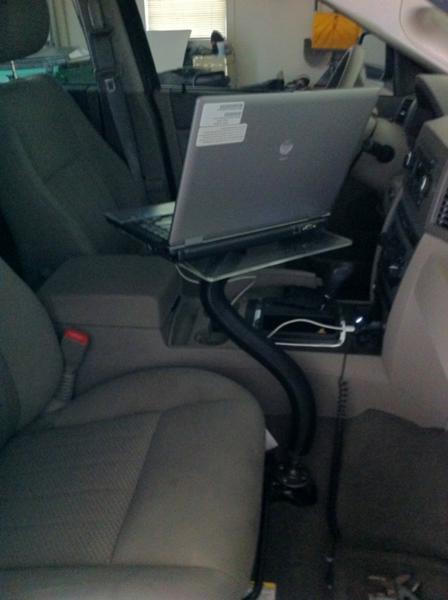

It has a base plate that I attached to the seat slider on the passenger seat.

Looks nice. I wonder how that will go with my stick shift

That was only $40?! WOW! That's nice! I assume it is fixed and does not adjust?

It sounds like ti is just pipe so i bet you could just but a few elbows and unions and make it adjust any way you want.

I added a 3/4" union to the bottom. It allows for easy removal and does allow you to rotate while still keeping secure while moving.
You can customize the setup you are looking for with additional pipe and elbows/45's. For that setup, I spent like $3 on extra fittings to get it over the shifter and I can still utilize the cup holders.

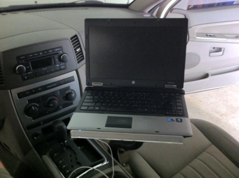

Here is a shot from the drivers seat.
