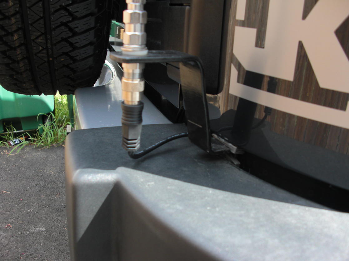

I made a custom Mount for mine. I didnt do anything fancy, a piece of flat steel from Lowes, big ol hammer, a drill and 2 bolts. A little over 4 dollars for this mount. A little time consuming only because in order to get the bends right you have to take the bumper off and on to make sure it fits through the tight squeeze. I put a few pieces of thin foam inserts with double sided tape to make sure the mount doesnt scratch the paint. I cant get all the pictures to post for some reason but I have it mounted by attaching it to the bracket holding the bumper on. Click image for larger version

that looks really good but brings up another question, the cable I have has a loop on one end it is more like an eyelit then a connection, it also has a piece of plastic inside the center of the loop....? they said it would work with what I got but Im a newb and not tracking what to do with it.

it sounds like the kind of cable you have would actually let you make the mount closer to the bumper than mine. You can get different kind of antenna bolts so just get the one that doesnt have a coax cable connection on it and it should work.
