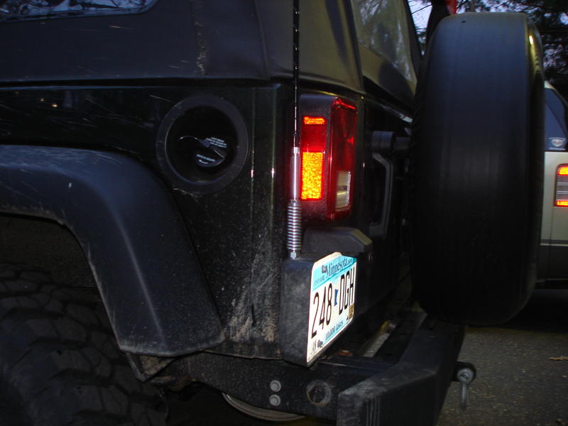

Originally Posted by BLK08JK
Maybe a dumb question here, but can I use a spring and a quick disconnect together with the antenna?
Name:	firestick spring 1.jpg
...no problemos.
