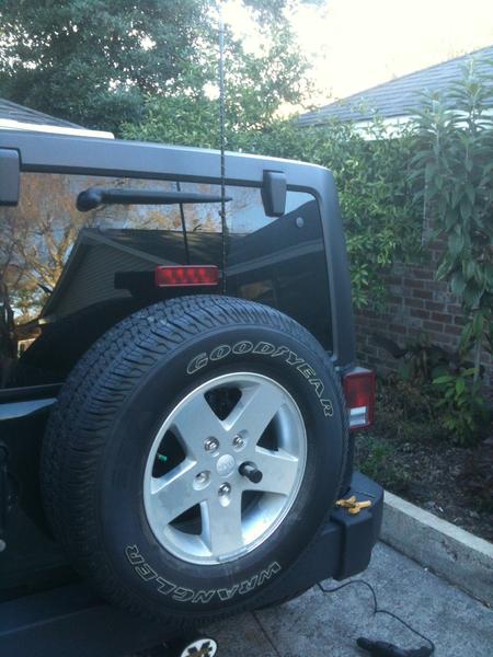

I couldn't really find a spot I liked in the JK to install my 20 year old Cobra 20 CB so I picked up the popular Cobra 75 all in one unit and thought I'd share some pics of the install...
First the antenna, a 36" Firestick mounted to the spare tire carrier (purchased the mount from a local CB shop that sells through Quadratec). The antenna cable is routed through the same rubber grommet used by the brake light wires.

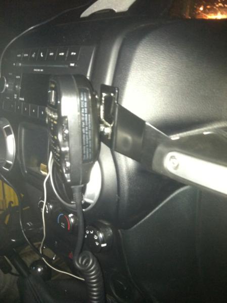

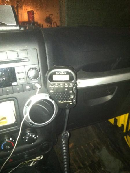

Cooltech VersaMount with cb mic bracket riveted in ...
Finally, the mic mounted on the CoolTech VersaMount:
That's it...it sounds great and the antenna tuned real well...off to the trails !!!

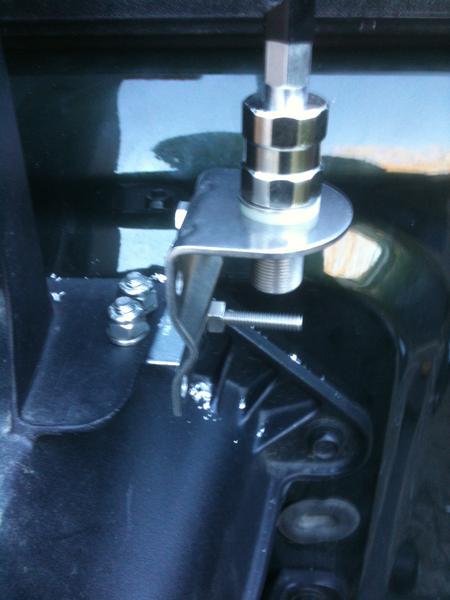

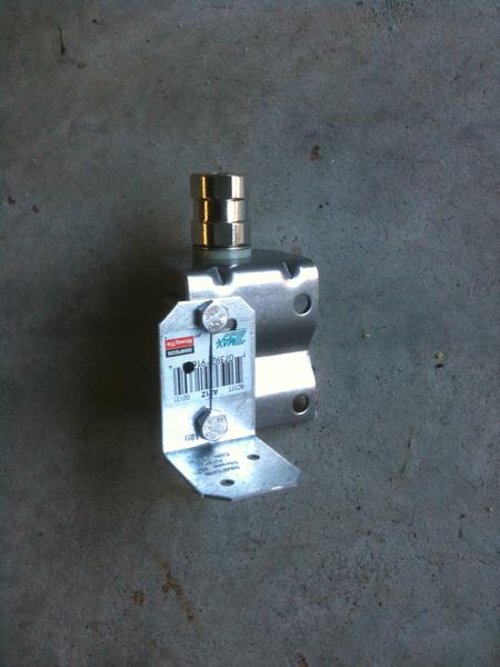

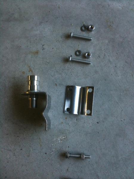

I finished my install today. Now all that's left is to tune it. Same basic install up front as everyone else. Here are a few pics of my antenna mount. And yes, the mount is grounded to the subwoofer bolt, it just wasn't installed when I took the pictures.

I didn't use the metal plate under the dash for the pass-through - just the rubber grommet. Will this come back to bite me? Should I go drill the holes and mount it?
This is the "metal plate" I'm talking about:

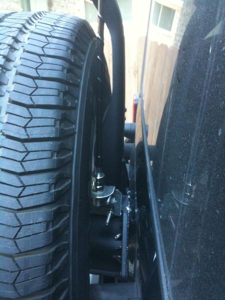

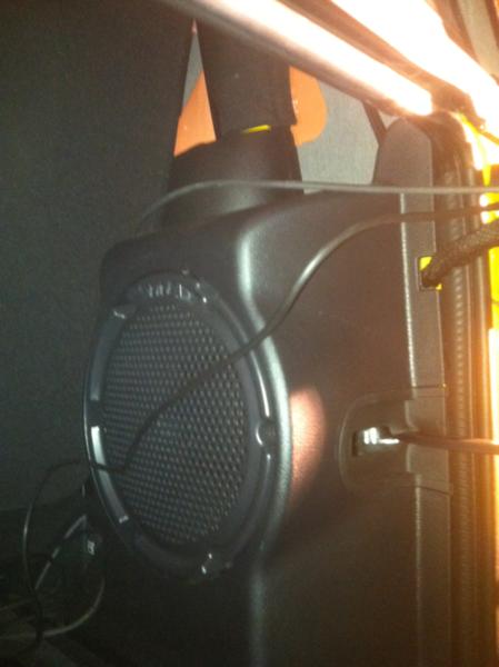

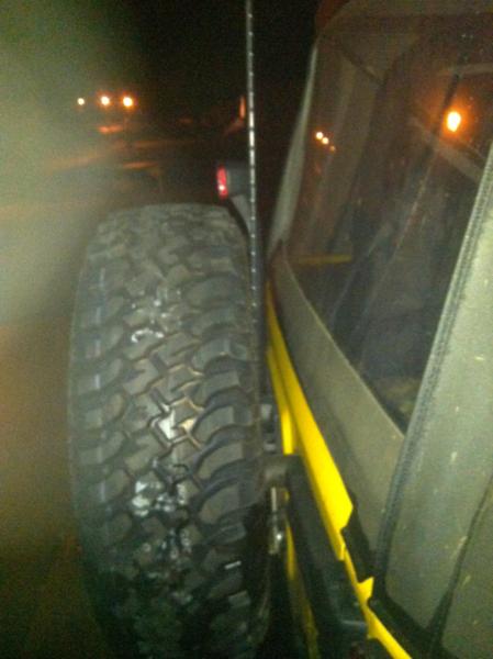

Finished the install, attached junction directly to the battery and secured the connector under center section of dash. Mounted mike using cooltech versamount, mounted firestick to tailgate mount and coax cable run along tube to main box and ground wire to inside acorn nut to rear speaker, all wires hidden to clean up look.
