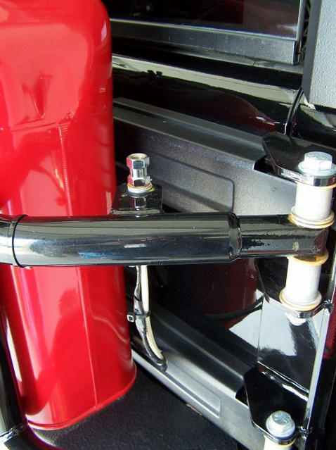

That shows two wires. One is the coax. I am going to guess the other is for the CHMSL.
Ok, based on that pic and the first one I think I understand. Go back up to your original post and look at the first pic. On the right is the antenna mount with the antenna adapter already attached. The antenna cable will just plug into the bottom of it. If that is your setup, the coax is grounded as soon as you plug it it. If you don't get good ground readings when you attach the adapter you can put in a star washer. It will bite through the paint and gound the outer part of the connector to the mount.

You might be right on the CHMSL - I didn't think of that (Since I never put mine back on).
