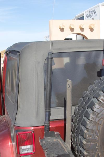

That Scorpion is a monster! Makes the ATAS120 look like a little baby. Probably why the Scorpion crushes the ATAS.
Here's the ATAS on the Breedlove mount.

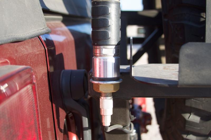

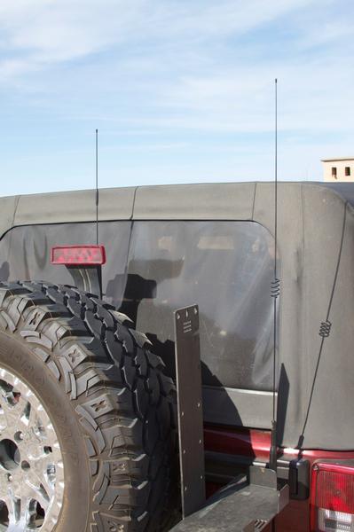

ID:	149003Click image for larger version

Goldtr8,
I like that mount, how is the ground plane for that antenna? Also did you make that mount yourself if not where did you purchase it?
Rfrogman, I also like your rig set up, where did you purchas your mount? does it give the antenna a good ground plane and will it work for a Standard spare tire carrier as I am not planning on upgrading it for now?

Originally Posted by KC7NFF
Goldtr8,
The reason for questions concerning ground plane is that I am thoroughly confused about this subject and do not know exactly how give mobile antenna good ground plane on my TJ?
My mount is a high-breed. I fabbed the aluminum plate to attach the standard US/NATO mount to my tire carrier. You should be able to fab something similar to attach to a standard tire carrier. It does provide a good ground plain just like it does on the back of a HUMVEE.
Goldtr8,
I made it myself to tie into the hinges so I don't stress the sheet metal.
