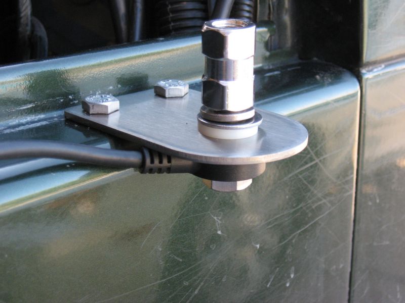

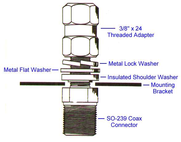

You need a antenna mounting stud. If you got the "firering" coax it needs a special antenna stud Model: K-4R.. All "antenna mounting studs" will have a white washer, flat washer and locking washer. You might find one with a spring? The stud mount should look like one of the following. It is very important how you put it on there too.

That last image brings to mind having a multimeter. It is a good idea to have one to test continuity. You can find one for less then $10. They are also good for testing batteries. Like AA or car batteries. If everything goes good you might not need one.
With the Firestik firering coax you have to do just a bit of soldering. At least with the kit that I got where one end was off. Basically one of the ends doesn't come with the PL-259 connector on so that it is easier to run. You end up having to solder the wire that goes in the center pin to the center pin. It is like putting a wire into a piece of macaroni and then needing to solder it there. Pretty easy, but you need the supplies (soldering iron and 60/40 rosin solder). I think if I was to do it again I would just get regular coax without the ring and the special antenna mounting stud that is needed.
There is a good chance that your going to want to run a ground wire to get better/lower SWR readings. For that you can get what you need by the foot at most hardware stores. You would want at least 12g and bigger lower gauge wire would be better.
There are a ton of people who think that your radio (cobra 75) needs an external speaker to be loud enough. I would get a small one and mount it up by your head on the roll bar. Check this post https://www.jk-forum.com/forums/jk-w...bar-pad-48921/
Good luck
