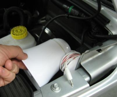

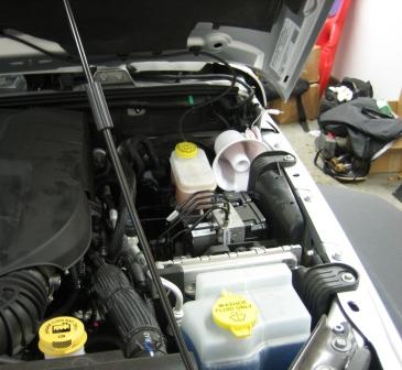

I just got my Speco SPC-5P 5" PA Speaker Horn. It's pretty darn loud over the engine where I'm going to mount it.
SPECS - I added these because a lot of sites don't list them
15W max
8 Ohms
Sensitivity 105dB/1W/1M
Comes with 10 ft cord with the 3.5mm Plug
5"X5"
Plastic and waterproof
I feel like sort of an idiot being that it is plastic and I could have gotten an aluminum one for about the same price. Being that it is in the engine bay hopefully that wont create any problems from the heat. I found a good place to mount it where I think it won't get too hot and is plenty loud paired with the Uniden 520. I'm waiting on getting the antenna before I put it in for good, but I did a test with some duck tape and it looks to be a good spot. To put a horn in there over 5" in diameter you would have to bend or cut it. It's sort of wedged in there where it takes almost nothing to hold it. I'm going to drill one hole up by the cowl and bolt it in.

I posted a couple up but that was before it was installed. I took some pictures of the horn while extending my axle breathers. (WRITE-UP->https://www.jk-forum.com/forums/jk-w...al-2dr-246787/).
I'm pointing at my new breather location here, so never mind that
I drilled one small hole here and added a dab of touch up paint. I ended up just using that one brass bolt to hold it on.
I didn't need to extened the cord on the speaker to attach it to my CB radio mounted above the rear view mirror (No Drill Footman Loop (above rear-view) CB Mount How To).
