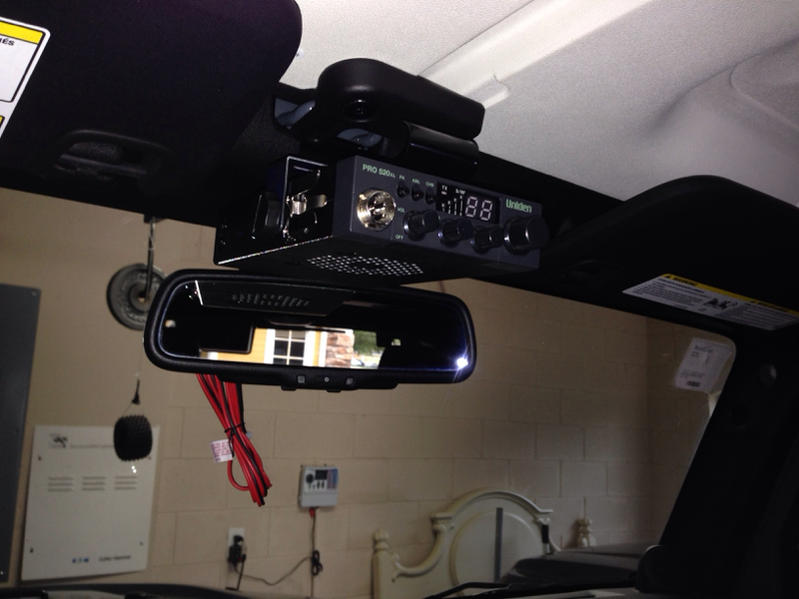

Guys, just wanted to thank all of you for the help. Finally had a chance to rework my setup yesterday and tested it out last night. Couple of miles range and it sounds great. The issue was all ground related. I played with different coiling of the coax and really didn't see a difference in SWR so take that for what it's worth. Thanks again. This forum has always come through
