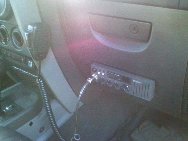

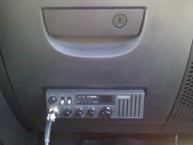

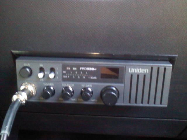

I think the best place is thru glove box run it flush on bottom with inside and you only lose 2 - 2 1/2 inches and the best part is it locks with ign key i bought the tuffy over head console it was huge and seemed to much for little cb this is clean and easy only cost is trim for car door cut at length put on ruff hole and slide cb in screw cb to back of glove box and thats it works for me here are some pics
