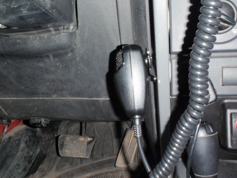

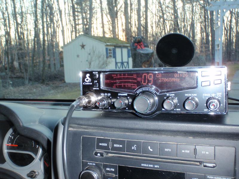

I'm new to jk-forum and to my 2012 jk. I bought some extras for it, just haven't put anything on yet. I was thinking about going with my dad to the jeep jamboree and was told i need the cb radio for the trail ride. I purchased the same cb you have here and was just wondering if you had a picture you could post of how you mounted it.
ID:	287556Click image for larger version
ID:	287557 there you go i hope this helps sorry havent been on here in awhile you should have pmed me
