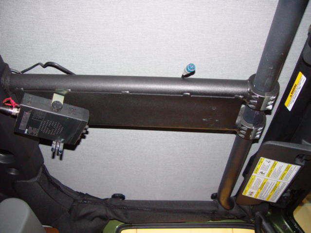

I mounted my Midland on the Rock Hard cage, the coax is 18'.
