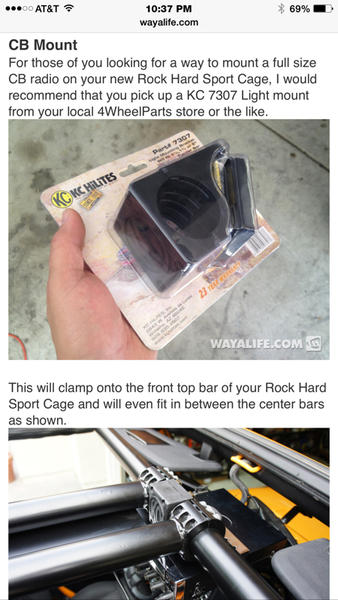

I love my bearcat. Hey what mount is that fitz?

I have rock hard sport cage and used kc hi lights tube light bracket. Works great

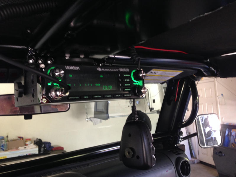

I am running the uniden 880, and have been very impressed with it. Like you, I wanted a more modern looking unit so it didn't look out of place in the front of the cab as well as a built in calibration too because when it comes to optimizing radios for signal and transition strength.... I have no clue. This this feature was important to me. I also liked that the unit was 3 inches shorter than the cobra 29xl and had a multi color display.
The unit itself had a quality build and the speaker is beyond loud, which is the reason I didn't go with the smaller midland or cobra 75 model. I mounted mine up high on a mount I fabricated.
CB Magazing also has a YouTube video on this exact model. It has two parts and essentially explains everything, what it does and how to use it. It's worth a look.
Build 9/10 " cb mic mount screws were to small"
Looks 10/10
Ease of use 9.5/10 " instructions were not good"
Sound clarity/ quality 10/10
My set up:
Uniden 880
18 ft Amazon cable
Rugged Ridge cb antenna mount
screw mount antenna holder "firestik brand"
HD spring " firestik brand" hd is a must stay away from the light and Medium duty springs.
4ft firestik.
Side note* I did have to bend the rigged ridge antenna mount as the antenna would not clear the stock rubicon tire and I did not have to file off the paint to obtain an SWr of 1.0
Hope this helps. Good luck.
