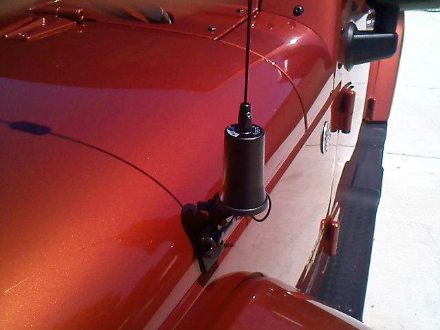

FWIW, this is what Im running on my 09.
Diamond mount with a Larson 2/70 NMO antenna.
Using a HT, it seems to do really well.
Hope this helps.
Hope this helps.
I like that setup..

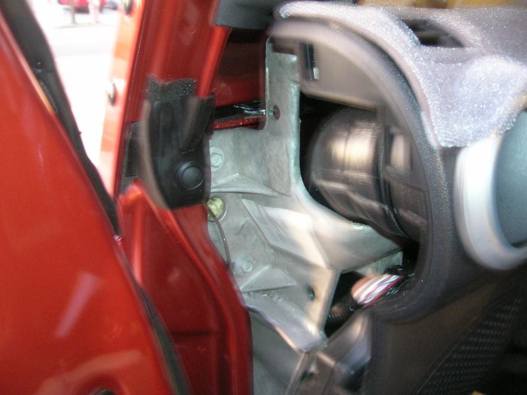

Now, next challenge: where/how did you go through the firewall with the coax?
Old Nov 22, 2009 | 05:25 AM
donnie's Avatar
Posts: 1,460
From: Simi Valley, Ca., Taylorsville, Ut. and places in between
There is a panel on the drivers side of the dash.
Remove it and you will see a piece of foam.
Poke a hole thru the foam with a coat hanger into the engine compartment and pull the coax
thru the hole.
Refill the hole with expanding foam when finished to reseal.
Here is a pic of the foam area and where I ran my coax.
Hope this helps.

Yes, I do come through that spot with the wiring for my KC windshield lights; the challenge (which I didn't mention in my previousd post) with the antenna coax is that it already has a mini-UHF plug from the mfg. which appears to be too big a diameter to fit.
I did note a grommet not far from there that I believe carries the washer hose for the rear window, so I likely will try and go through there.
Old Nov 23, 2009 | 07:15 AM
donnie's Avatar
Posts: 1,460
Greg,
The end of mine has a SMA fitting on it.
The way I got mine thru was I stuck a piece of wire thru from the inside and taped the coax then pulled it back thru.
Makeing sure that everything was as compact and smooth as possible.
Hope this is of some help.
