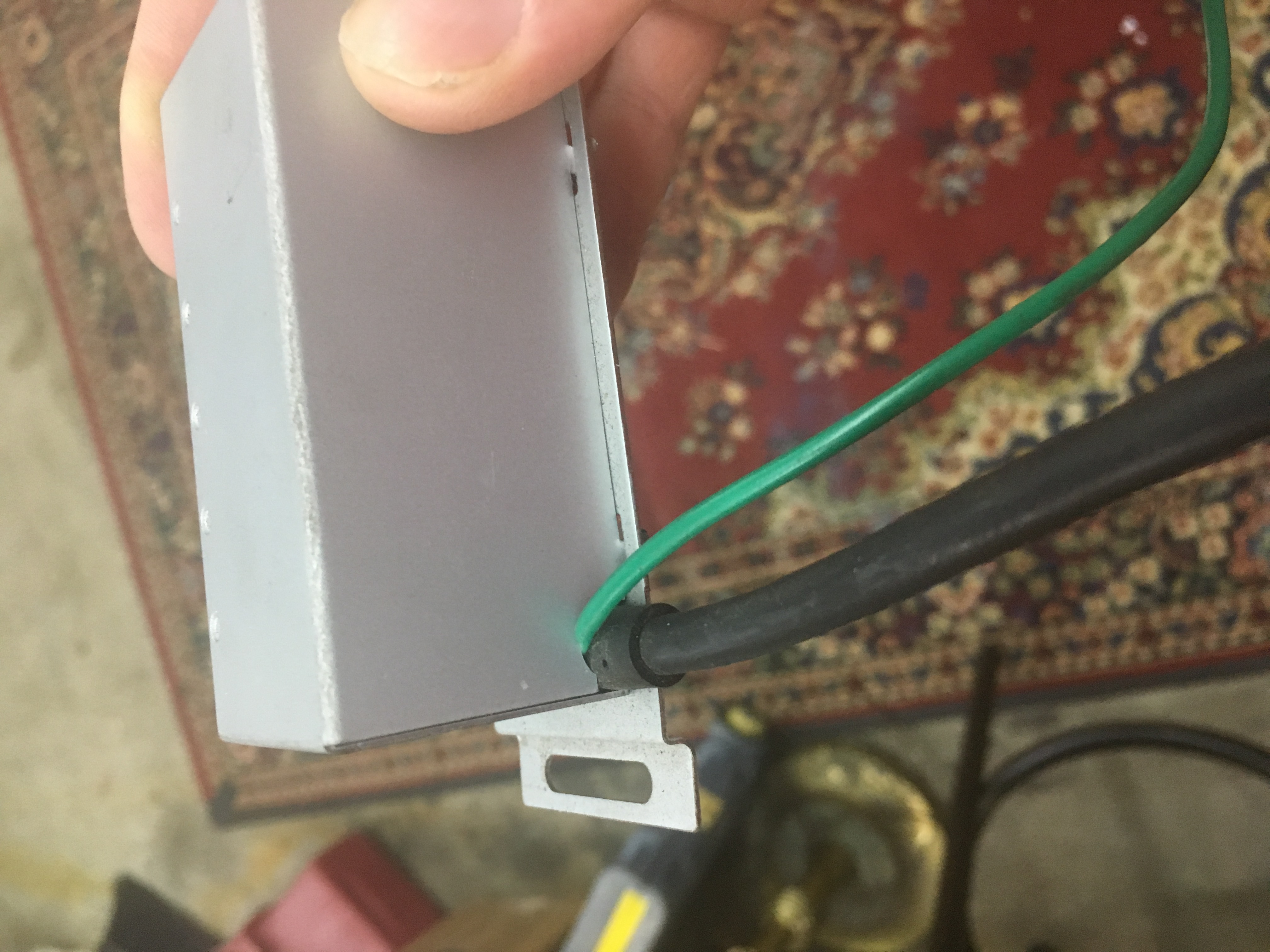

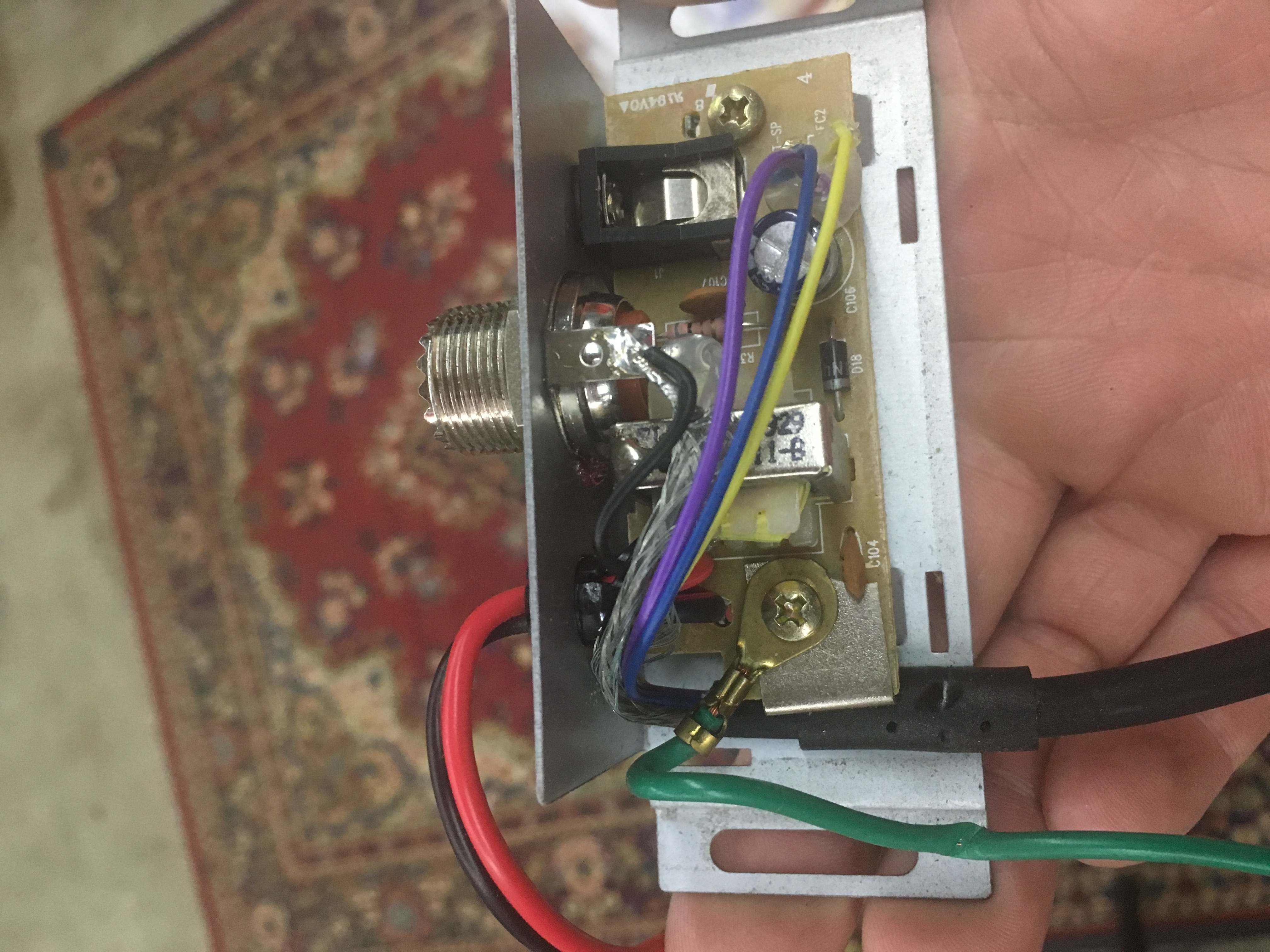

I had this happen with my 75 as well. I actually got the red lightning bolt dash light to come on when I keyed the mic.
I had the CB wired directly to the battery too.
The solution was more grounding. I also didn't have the remote box mounted.
I opened up the remote box and added a ground wire to the PCB.
I also ran a ground to the mount.
Since then i've done a lot of research regarding 2-way communications and Jeeps. Bonding with braided wire is everything. The JK has a pretty poor grounding system. Bonding made a HUGE difference and even handled a minor missfire I was having. (another story)
Attachment 660840Attachment 660841
I moved it to the battery today and still the same problem. Does the brain have to be mounted? Mine is just behind the glove box.
