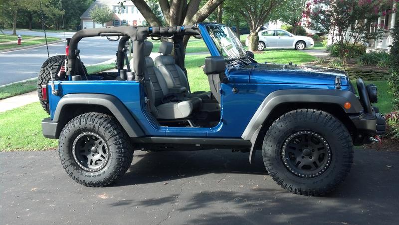

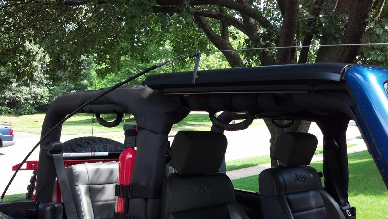

Originally Posted by Chefbrujo
Aaaaahhh that makes sense. Well i would want to rig it so i can bend it down and have the end somewhere near the front windshield for hiway travel and when needed. Isnt that a good enuf work around?
I have done just what you are talking about. I put a ball mount on the right rear fender and when putting it in the garage, I pull the antenna forward and clip it on the rain gutter.
I use a quick antenna disconnect so I can switch between antennas, one for 20 Meters HAM, 40 Meters, and a 102" whip for CB. If you set it up right, you could switch out the antenna for a Firestick also.
The problem with the 102" whip on the trail, at least in the East, is that it hits every single branch and flies all over the place when it "whips" back to vertical. This gets to be very annoying after several hours.
