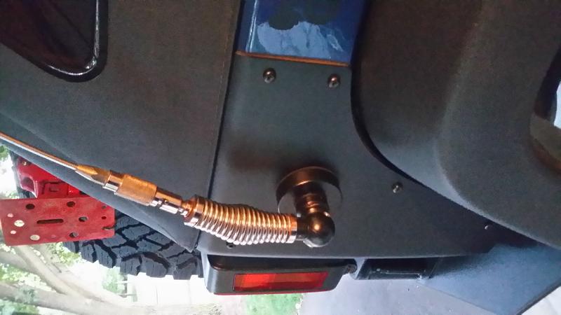

You can plastidip the antenna and the mount, but you must be careful that the connections between them are not coated however. Also make sure that the mount is making direct contact with the metal of the body. Scrape the paint off to make sure, and use those lock washers with lots of teeth around the edge to bite into the metal. You can hit it with a rattle can after everything is completely tightened up so it doesn't rust.
Here are a few closeup photos, I installed the AEV corner guards and the antenna is now mounted on it. Also, just as important is the antenna mount. I have this one, and it is the absolute best mount you can buy. https://breedlovemounts.com/CB_antenna_ballmount.html I also used the Breedlove Puck baseplate so no bolts are showing on the outside.

I've used some of the Breedlove mounts. Best quality I've seen.
