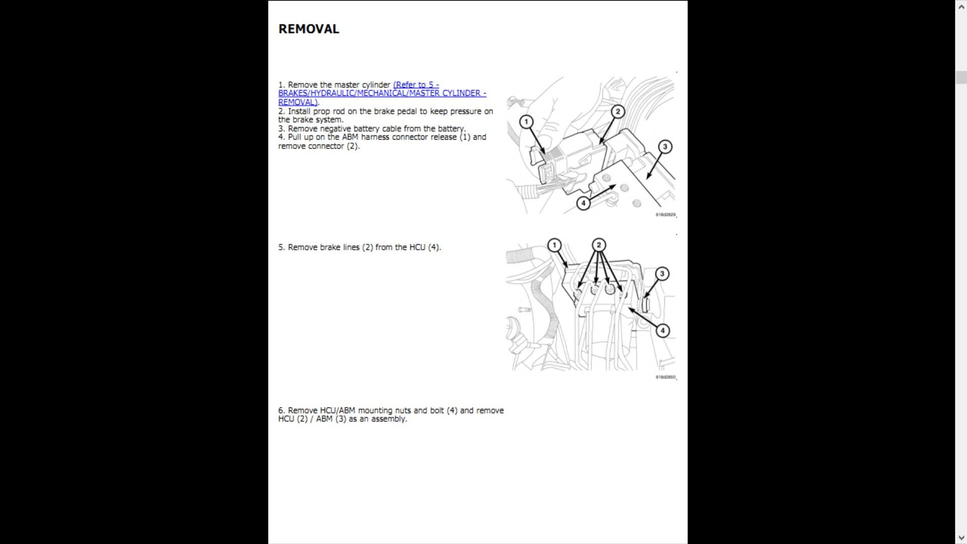

Another thought: Since the ABS light is on (which is suspicious itself), disconnect the ABS and see if the symptoms change. Below is a screenshot of the connector and how to release it. Remove battery neg beforehand, and wrap the connector in something like a plastic bag to insulate the pins before connecting the battery again. Disconnect battery negative before re-connecting, and make sure it's clean. Mistakes here can damage stuff, so don't do this if it feels like it's outside you're skill set. This is far outside of any troubleshooting in the manual. Similar to removing the connector for the swaybar e-disco, the idea is to find a likely suspect to disconnect and see if the symptoms disappear or change -- The ABS lamp should stay on since it's disconnected and would appear failed to the rest of the system. Also, if the check engine light stays on try to retrieve the codes.
