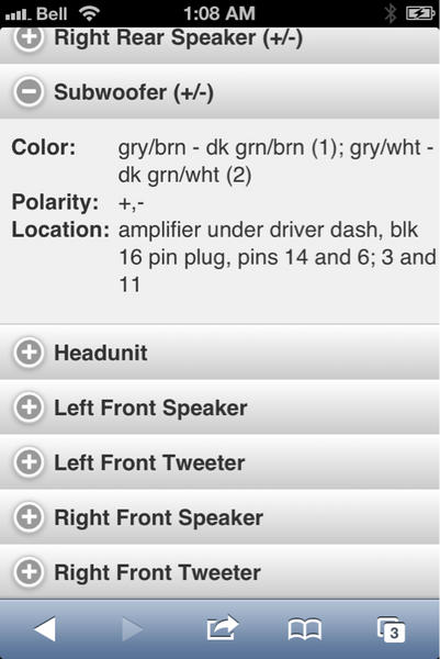

Does your factory sub still work? If you have the upgraded infinity system you can't use the speaker signal to run your sub. The speakers put out no bass just audio. There should be 4 subwoofer wires running to the sub just under the carpet at the rear wheel well. Or u can get them at the factory amp. Hope this pic helps!
