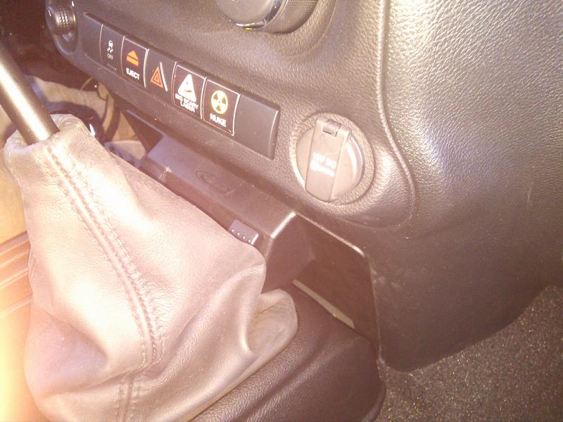

i got mine in my maual but its a tight fit
Attachment 281173
Wow. I'm eating crow now. Looks like I'll be back in the Jeep come first light. Do you have any problems shifting? For the life of me, I could not get the center console to get in around it......

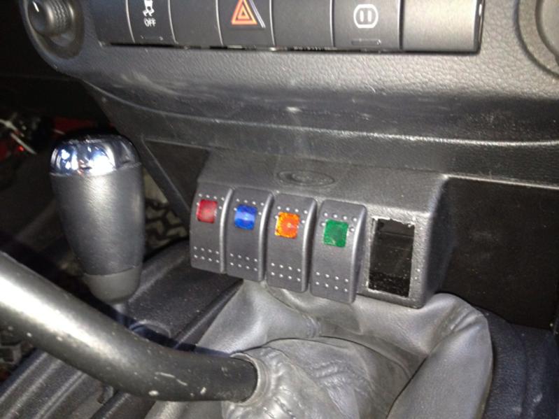

I got the Daystar in with some jimmying. I had to remove the center console (just the front part), and then completely remove the manual shifter boot. I put the center console back in and slid the Daystar in. I I pushed the boot back in from the top and clicked it back into place. I'm having no problems with it hitting yet.
Daystar with shifter down in 3rd

Daystar in 5th. I need to put the boot down

I'm still thinking the upper visor mod might look nicer.....

if you push the shift boot down in like i did in my picture it does not interfere with the switches at all
I did that right after taking the pictures! It works fine, if a little cramped.
If anyone from Daystar is watching this thread.......To make it work in a manual without issue, all you would have to do is change the angle of the switch plate a bit and it would work fine.......
Thanks krzfirefighter013 for figuring out that this would work.....
