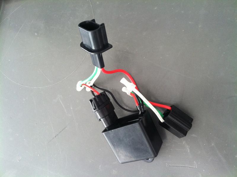

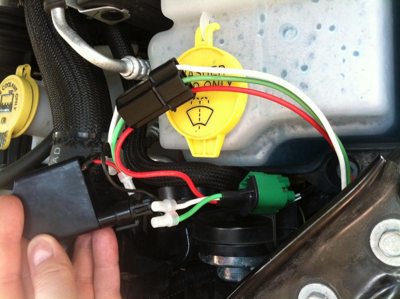

SUCCESS!!!!!
I realized that I had a pair of the DDM Tuning error code eliminators in my garage from an old HID kit from a previous car of mine... Clear throat... Don't tell the illegal headlight cops on this thread like Hilldweller about this fix. Joking. HA. I'm sure he'd appreciate that this ended up eliminating the flicker.
I soldered them inline with the low beam + and - running off the factory harness and the "flicker" is gone. I ended up taking out the ARB direct battery harness that I bought previously and will save it for another project down the road. No longer needed.
Soldered inline with low beam positive and negative in wiring adapter, then soldered a wire for ground for high beam to allow the high beam to bypass the error code/anti flicker eliminator.
Installed adapter.
Flicker is gone on low beam. Repeat on high beam if you regularly use the high beam. If you don't use high beams regularly like me then the mild pulsing of the light at idle will be acceptable when using the high beam. If I end up using the high beams more I would recommend putting two of these on each light, one for low and one for high. Because I can count the amount of times I have used high beams in the past year on one hand I will just leave these as is with one error code/anti flicker eliminator on just the low beams.
YOU DO NOT NEED A DIRECT BATTERY WIRE HARNESS FOR THESE LED LIGHTS. SAVE YOUR MONEY!!! For less than $20 you can skip the expensive SMS or ARB harnesses and just use the factory wiring with these inline HID anti flicker/error code eliminators. They do in fact smooth out the PWM that the 2012's have with LED lights.
