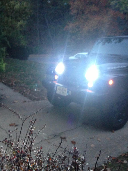

Got the correct relay today and had the kit installed in 35 minutes. Lights look great and no flickering or lamp out light. 1000x better than stock and its not even fully dark out yet.
