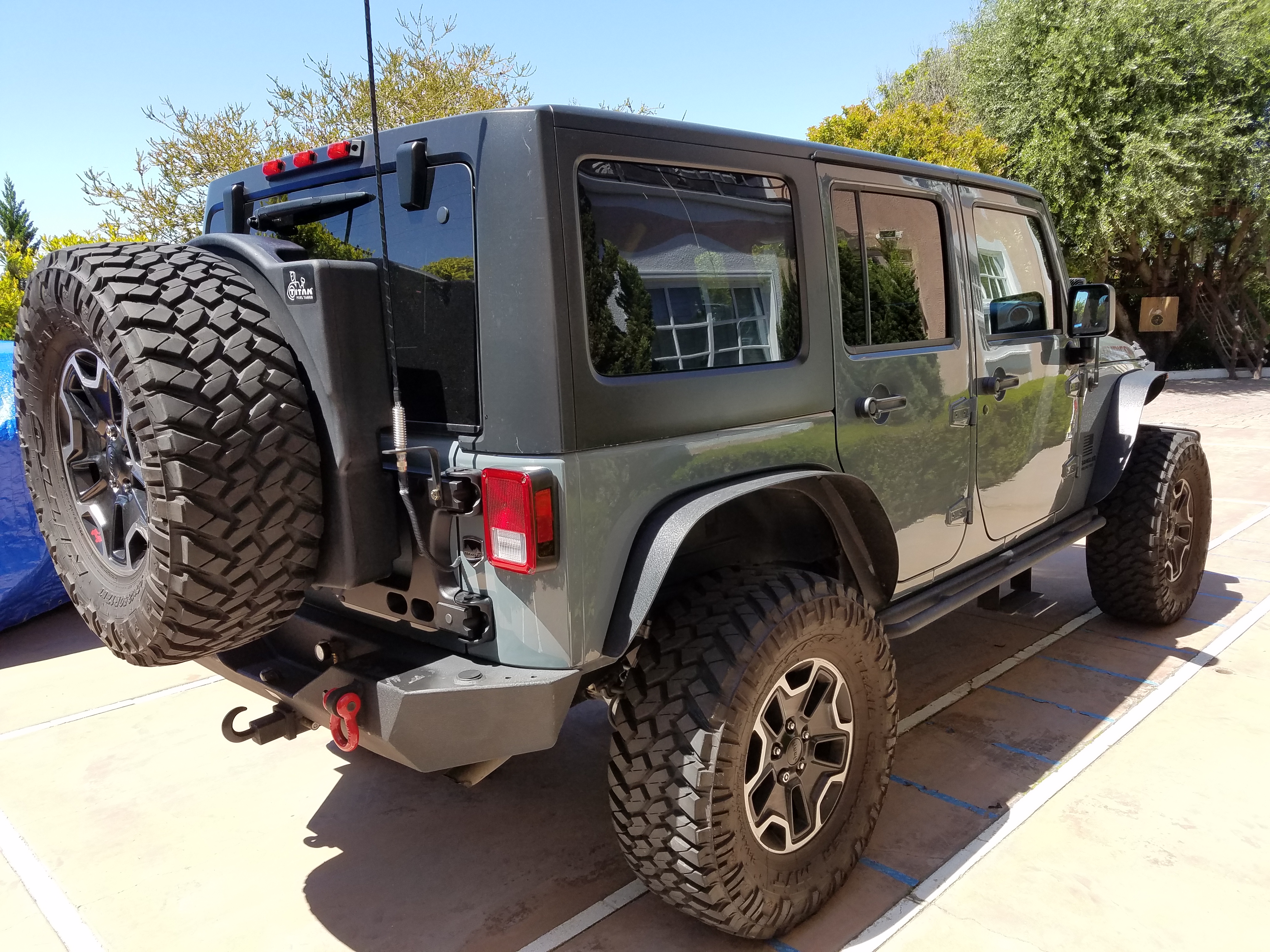

I ditched the 3rd brake light altogether and went to Lowe's, picked up a trailer LED light and installed it on the hardtop (my hardtop never comes off).
