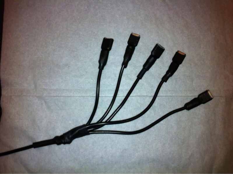

Below is the first step: The ground wires for the lights in the switches. All hand soldered and heat shrunk by me.
Tomorrow, I think I will work in getting the switches to fit in the A pillar switch pod.
Attachment 336675
Not bad. But if I may? I would suggest using a "dasy chain" method for this procedure. This method makes a more reliable connection. And it looks better too.
Thanks, I think you're right. I'll try that with the next set of wires (positive from dash lights)

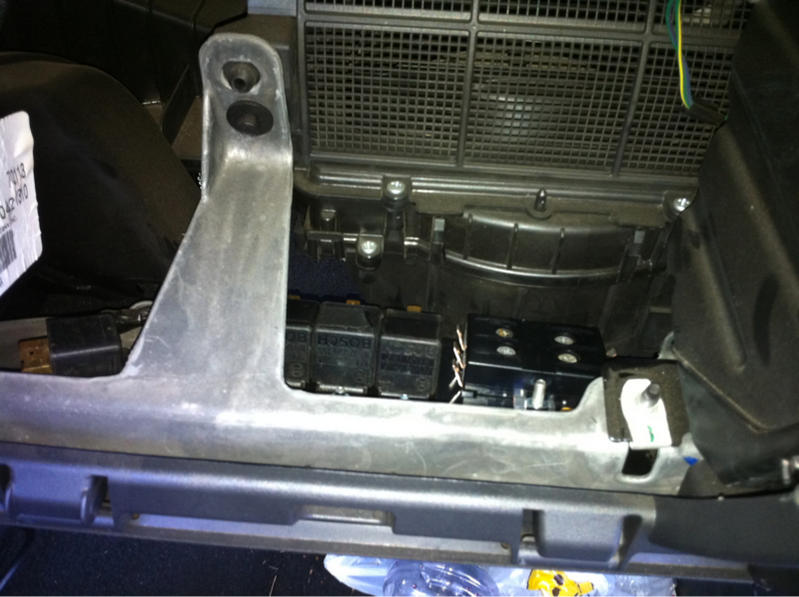

I am doing the same thing adding lights and a few other things to my 2010. I found a nice little place to put a 6 fuse fuse block and 5 relays mounted on a broad. If u take out the glove box and look down right where the glove box hinges theres a space where u can put it. If u need a pic I can get one later to day. I built a switch panel be hind the gear shifter. If u need more info let me know.
Definitely please. Any help is appreciated!!! I have been searching for a good spot to put the fuse block and relays. I will check out that spot.

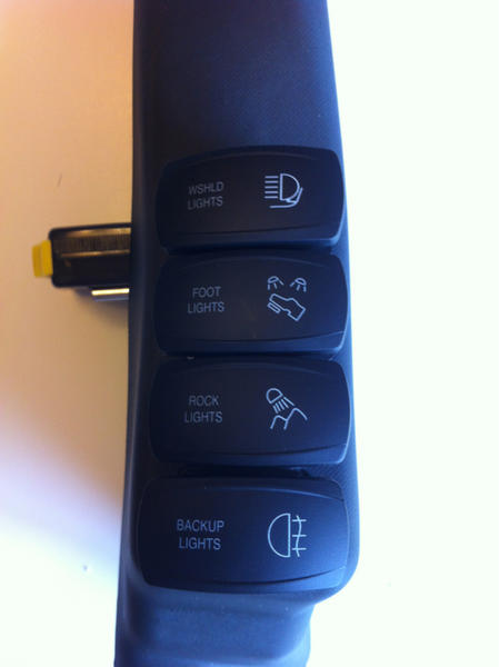

Part 2 - I cut out the slots in the A-pillar pod for the switches.
It seems that many people are sanding down the sides of their switches to make them fit. I couldn't bring myself to do it, the switches are just too good looking.
Since I didn't already cut the pod, I decided to make my own cuts slightly offset from the stock markings.

Old Jul 3, 2012 | 12:34 PM
I'm putting some electrical accessories in the Jeep and the wiring is proving to be somewhat complex. I just need to take my time and be patient.
I have 4 custom made switches from OTRATTW and VisionX windshield lights, Tantrum LEDs for rock lights, 2 100w lights for reverse (auto mode and manual) and I'm planning to add LEDs for footwell lighting.
I'm having a hard time find space in the 2011 JK to put the fuses and relays, but I will figure something out.
I'd like to use this thread to chronicle the various activities required to put this all together.
<img src="https://www.jk-forum.com/forums/attachment.php?attachmentid=336675"/>
Here is my fuse/rely panel nothing fancy, put gets the job done. I just cut a piece of plastic of a old case I had. Then wedge it the hole under the glove box. I haven't had time to do the wiring yet. But working on it. Hope this helps.
